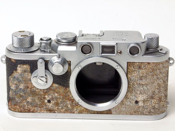

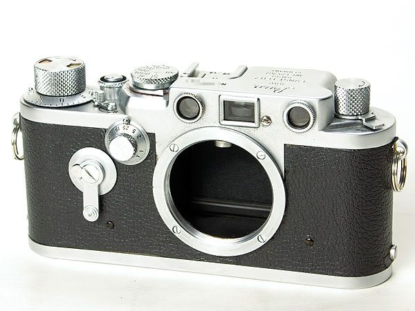

Rick, this is the $30 bad Leica IIIf I got- a red dial s/t type.
The shutter was gone -not just cracked or pin-holed.
Two days of work and some US$0.20 worth of vinyl leatherette, this is how
it looks now:
Couldn't get the selftimer to work right though. This must be the reason why some Leica repairists charge more for the self-timer models.
