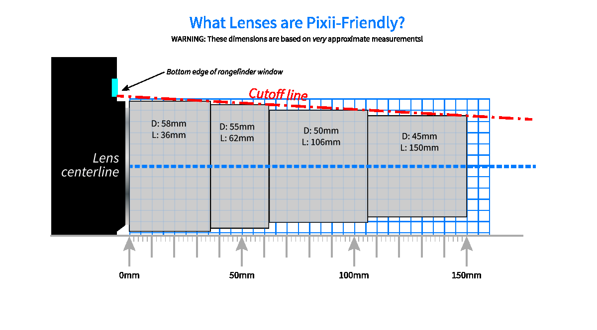

For people who would rather look at a picture than at trigonometric calculations (which is all of us, since this is a photography forum, right?) here's a graphic representation of my crude calculations above. Downloadable actual-size PDF version here.
Friendly warning: Before anyone gets too invested, literally or figuratively, in these numbers, keep in mind that I derived them by measuring strips of cut-up paper!

there are vented and conical hoods for the 50mm summicron f2. I have the newly issued hood from Light Lens Lab which also fits the 35 summaron. Extremely well made and match for Leica lenses. Perhaps the vented one is most appropriate for the Pixii?
Yes: I have one fitted to mine because I really dislike the built-in, slide out type of lens hood quite a lot.
G
hap
G
The LLL non vented hood has an OD of 55 mm. Seems Pixii friendly according to Ranger9 estimations....for those who will ultimately own a Pixii.
