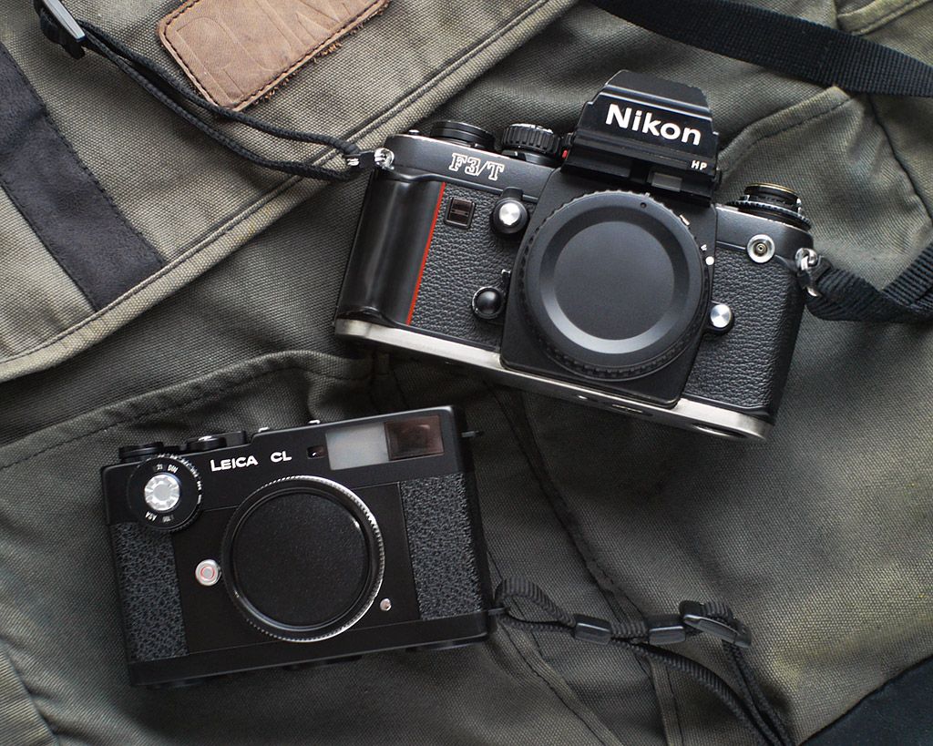

Hi, got these two with inop metering.. is it still repairable, I know that CL still does but wonder about the F3\T.. and is it worth for repair?
jwicaksana
Jakarta, Indonesia
Are you the same yesaroos I know? If yes, why don't try to bring it to om Halim and see what he thinks? Nice score BTW.
yesaroos
hi Jonathan..
