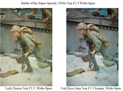

Ludwig Bertele’s Sonnar is a break-through formula that embodies fast optics in a compact design. 2021 is the 90th birthday of Bertele’s 5cm F2 Sonnar. This lens is the first Sonnar to be introduced for the new Contax camera. 2022 is the 90th birthday for the 5cm F1.5 Sonnar.
2022 was a good year for me, two very special Sonnars came my way. The first- Ninety years after it was manufactured, a Carl Zeiss Jena 5cm F1.5 Sonnar from the first batch of 100 lenses completed, October 1932. This can be considered the trial batch, the optical formula and design of the lens was changed soon after. The second very special Sonnar is the Skyllaney pre-production 5cm F2 Bertele Sonnar.

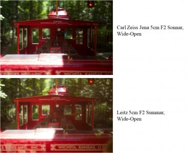

The Carl Zeiss Jena 5cm F2 Sonnar and Leitz Summar 5cm F2 first Fast lenses offered for the Contax and Leica respectively.
The Sonnar design has two less air/glass surfaces, more transmission and higher contrast. The Summar has better flatness of field, and more astigmatism. "Swirly Bokeh" is the result.
In 1932, Zeiss brought out the 5cm F1.5 Sonnar with 6 air/glass interfaces. Leica brought out the 5cm F1.5 Xenon, 7 elements in 5 groups for 10 air/glass interfaces. For low-light work, the Sonnar is the clear choice.
The classic Sonnar was the super-speed lens of choice of the 30s and 40s. The 5cm F2 Sonnar was 6 elements in 3 groups, 1-3-2 configuration. The 5cm F1.5 Sonnar was 7 elements in 3 groups, 1-3-3 configuration. Add them up- 6 air/glass interfaces for more transmission of light compared to the 10 surfaces of the Leitz 5cm F1.5 Xenon. The front element of the 5cm F2 Sonnar is soft, similar to the Leitz lenses. The front element of the 5cm F1.5 Sonnar is hard, making it much easier to find a clean example. Scratches and cleaning marks are common on the F2 Sonnar, as they are on the Leitz Summar, Xenon, and Summitar. This is one of the reasons why Skyllaney chose to build the 5cm F2 lens. Some 20 years ago I was lucky to have found a 1934 5cm F2 Sonnar that had a filter on it from the time it was sold. That lens is also the first that I converted to Leica Thread Mount using a Jupiter-8 focus mount. It is the lens that I dropped in the case to shoot alongside the new Bertele. The Bertele optical design is based on the 1934 5cm F2 Sonnar, and mine is as perfect as can be found. The optical fixtures and focusing mount of the Bertele have the build and precision of an Optical Laboratory instrument. The level of engineering and construction of this lens sets it apart from every Leica Mount Sonnar that I’ve used. The Bertele Sonnar is an engineering masterpiece, every detail of mechanical design thoroughly thought out.

I’ve been using the Bertele Sonnar alongside of my 1934 5cm F2 Sonnar since December 2022, on the Leica M9 and M Monochrom. I often take lenses to the Marine Corp Museum in Quantico, VA. The lighting is consistent and the subjects stay still. This gives a good way of doing a “walking around test” of various cameras and lenses and being able to compare results. The Bertele is sharper, and has higher contrast than the original- as seen in the side-by-side comparisons. Using the two lenses, the precision of the Bertele focus mount and aperture is among the best I’ve ever used. Including custom lenses made-to-spec for scientific work where we had the barrels made in inconel. That is expensive. The Bertele is all-brass, also expensive- but not as much as inconel. The build-quality of the First-Type Rigid Summicron 5cm F2 comes to mind when handling the Bertele. This lens recreates the rendering of the Sonnar 5cm F2 with modern multi-coated optics in a precision made barrel and focus mount that would make Ludwig Bertele proud. I am very proud to own and use this lens. I had a great Christmas!

Brian, thank you, not only for the history, but for the perspective and the example pictures (the hard data).
The helicopter gunner pictures seem to be the most different, with the Skyllanie lens showing more both in the highlights and the shadows. The other comparisons are very interesting as well. Again, thanks for doing this.

I have "at least one" 50mm F2 Sonnar formula lens from Zeiss Jena pre-war, wartime, post-war; Zeiss Opton; Nikon collapsible and late Rigid, Tanack, KMZ, Arsenal, and now the Bertele. My 1934 5cm F2 Sonnar used for the comparison above is the best that I've seen. It performs better than the Two 5cm f2 T Sonnars that I converted to Leica mount and currently own. As seen above in the Photo of the Helicopter Gunner- the original Sonnar loses contrast from the strong sunlight hitting the metal in the image, producing flare. The multicoated optics of the Bertele Sonnar handled the harsh lighting conditions perfectly.
