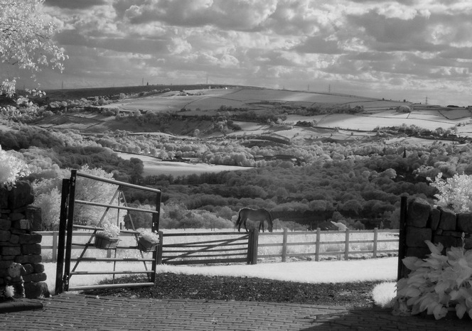

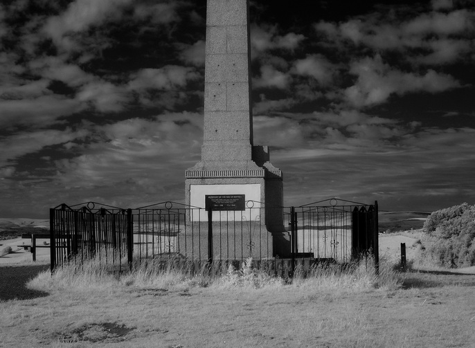

I love the look that I can get with SFX. Recently I tried to modify a P&S digi to see what could be done.
I learned a lot whilst tinkering with the 4Mp Minolta and more with the cheap Ebay purchases that didn't "make it" through the process on the kitchen table.
That was last year, I had put the camera away because
1: focussing was an issue, many shots well out of focus,
2: The winter was coming.
3: I had learned just how very difficult it is to cut and shape the glass filter,
4: And I learned how it is nearly impossible, on the kitchen table, to eliminate dust on the sensor/glass.
Anyway, having an afternoon free and having found it again, I tried a few test shots in the yard. I learned that the focus would work if not wide angle and that you can't see the marks caused by the specs of dust on the glass if the subject is varied.
Out to the park for a first few shots. I love this. I may buy a professionally modified P&S.
A Few......
Look West
West
Monument
Dawg
The dog is a Yorkie. It is brown with a black back.
