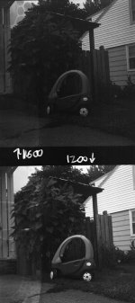

results two, too
results two, too
I'd also say that 400 won outside at EV12. 200 might have been better, but really it's not too bad. 800 was usable, and there was even a scannable image at 1200 and 1600.
