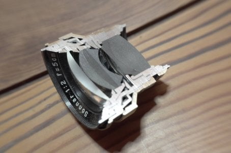

By the way there's even a German LTM (and Braun Paxette) Sonnar copy - Steinheils Quinon. From what I read the Quinons optical scheme was supposed to have been calculated by Bertele himself after he had left Zeiss and was more or less working as a freelancer and also with Wild.
Interestingly the Quinon has pretty much the exact same "close focus" mechanism as the Nikkor 5cm f2. You feel a bump, then rangefinder focus goes away and it focuses up to very close almost a full rotation of the helical. I always wondered if Steinheil came up with this and Nikon copied it or if it was the other way around.

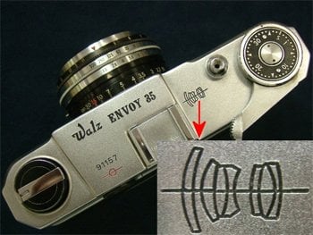

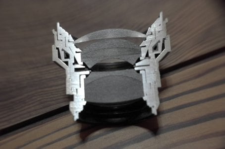

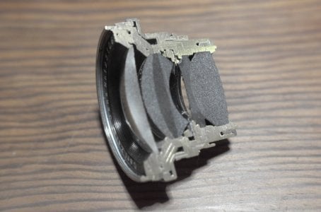

Oh and if you want to go really esoteric there's the Walz "Envoy" fixed lens camera which uses a 7-element Sonnar lens however in a realatively unambitious 4.8cm f1.9 configuration. The Sonnar diagram is even engraved on the cameras top plate! They were clearly proud of it.
Edit here's an image I stole from Kitamura's repair blog:
I have the Walz- it is a fine lens. Look at the surface behind the aperture.

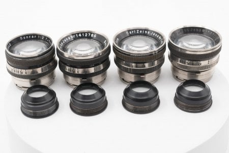

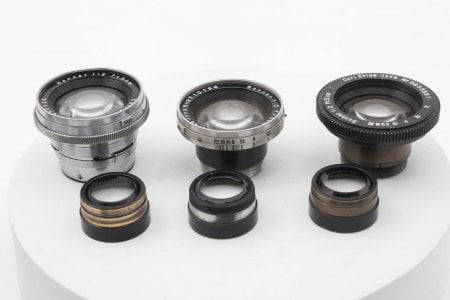

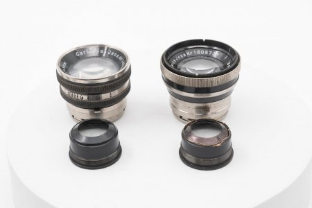

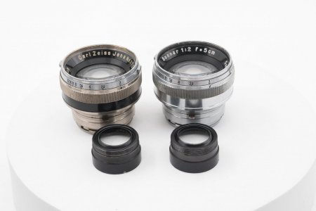

I finally had the guts to disassemble some of my Sonnars.
From left to right.
  1. batch 4 1932, serial 1383940, v1b ZJ CR bnA2, Thiele v1, front dia 31.75mm, rear dia 17.25mm, rear glass dia 26.2mm, rear glass height 15mm
  2. batch 7 1932, serial 1412786, v1b ZJ CR bnX2, Thiele v1, front dia 31.9mm, rear dia 17.2mm, rear glass dia 26.2mm, rear glass height 15.05mm
  3. batch 9 1933, serial 1421809, v1b ZJ CR bnV6, Thiele v1, front dia 31.75mm, rear dia 17.25mm, rear glass dia 26.25mm, rear glass height 15.05mm
  4. batch 11 1933, serial 1429139, v2b ZJ CR bnV6, Thiele v2, front dia 31.85mm, rear dia 17.25mm, rear glass dia 25.9mm, rear glass height 15mm
  1. batch 17 1934, serial 1455080, v3b ZJ CR bnV2, Thiele v3, front dia 29mm, rear dia 22.4mm, rear glass dia 26.15mm, rear glass height 16.9mm
  2. batch 25 1934, serial 1605737, v3b ZJ CR bnU, Thiele v3, front dia 29mm, rear dia 22.4mm, rear glass dia 26.45mm, rear glass height 16.45mm
  1. batch 28 1935, serial 1730522, v3b ZJ CR br, Thiele v3, front dia 29mm, rear dia 22mm, rear glass dia 24.8mm, rear glass height 15.05mm
  2. batch 35 1936, serial 1866371, v3b ZJ CR cO, Thiele v3, front dia 29mm, rear dia 22mm, rear glass dia 24.8mm, rear glass height 15.18mm
  1. batch 26 1935, serial 1630028, v3b ZJ CR cc, Thiele v3, front dia 29mm, rear dia 22.05mm, rear glass dia 24.8mm, rear glass height 15.05mm
  2. batch 64 1942, serial 2710196, v3b ZJ CR acT, Thiele v3, front dia 29mm, rear dia 22.05mm, rear glass dia 24.73mm, rear glass height 15.20mm
  3. batch 731945, serial 2853591, V3b ZJ M7 bg, Thiele v3, front dia 29mm, rear dia 21,9mm, rear glass dia 24.75mm, rear glass height 15.15mm
After showing all those different variations, the measurements and thinking about it my impression is that the information from the Thiele book is not correct. It is not the fault of Mr. Thiele. The information from those Zeiss production cards was not followed correctly it seems.
