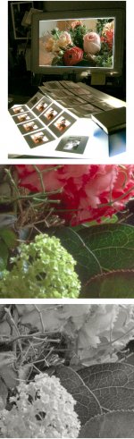

The 35mm slides and negs were shot with an Olympus OM-1 with mirror lock, tripod, cable release and a 50/2 Zuiko Macro @ f/8. That's one of the sharpest lenses available at optimum aperture.
I just doublechecked on the emulsions: The slides are Elitechromes 200, the B&W negs are FP4, developed in TMax 1+4 for fine grain and optimum tones (see unPSed 100% details of 2900dpi scans attached).
