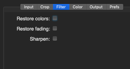

Also was wondering what your Vuescan preferences are for scanning Tri-X flat before adjusting in LR/PS. These are mine, though I'm not exactly sure why. Someone online had posted these settings online a year ago and I blindly took them on as my own since the guy seemed to know what he was talking about. I just use these settings every time and then set the white/black points, bump contrast to 50 or so, adjust shadows and highlights as needed, and bump clarity up to 5.
I scan at 3600dpi now.
