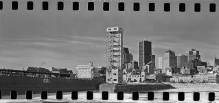

Just did some experiments pushing to 100 and 200 in Caffenol-C-L. Both in the vicinity of 70–75 min. at 20ºC. The roll at 200 came out a bit thin, but still usable. I'd maybe increase to 90 min. or so. Contrast seems to be pretty well in control; I actually added some to both, along with some burning and dodging.
img763.jpg by Thanimalia, on Flickr
img767.jpg by Thanimalia, on Flickr
