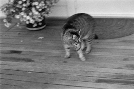

Thanks for input, Erik! Developing temps were probably following manufacturer's recommendations. I say probably, because it was nearly 20 years ago...and I was often drinking while developing 😅. I am sure that my developer temps were correct, though. The apartment I lived in had air conditioning, so I doubt that the rest of the chem was ever too hot (but I probably didn't ever check). The thing is, I had scanned these negatives at various points in the past and the issue wasn't present 10-ish years ago (the last time I scanned them). And none of the other black and white film I have from that era shows this kind of deterioration (it's only the Neopan 400).How do you develope your negatives? It seems that the emulsion layer has cracked. Perhaps the developing procedure was too hot or the film was stored too warm. The effect is called "reticulation". I have this problem sometimes when using Tmax400. I always try to keep the temperature of the different baths exactly at 20 degrees C.
Slumgullion
Well, on further examination, it does appear in my scans from 10 years ago. It's just that I was using a flatbed scanner at that time and the sharpness of 35mm scans was very poor and thus the reticulation was hard to see. With 'DSLR' scanning the apparent sharpness and resolution is much better and so the reticulation is more evident. Perhaps Fuji Neopan 400 was just more susceptible to temperature fluctuations than other films. Thanks, Erik! Problem solved.
