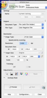

I have a iMac (Retina 5K, 27-inch, 2017) with Mac OS Mojave 10.14.5. I use the Epson software with the attached settings.
Only 'thumbnail'. There are no other settings in the preview mode apart from 'thumbnail' and 'normal'. The other settings are in the attachment
I posted above.
