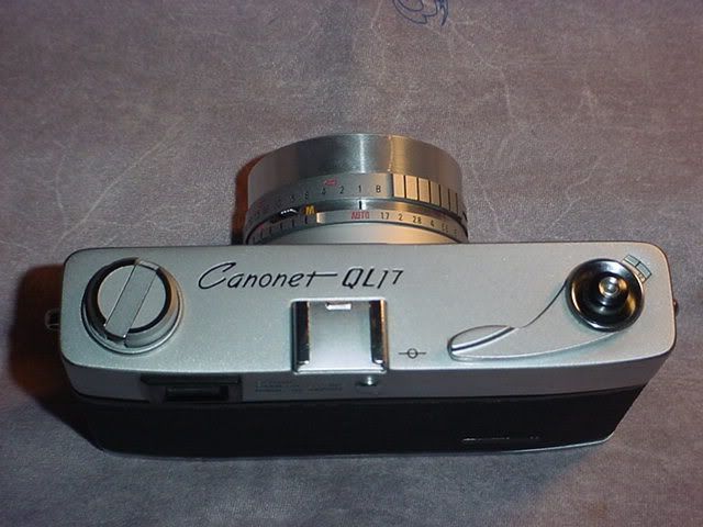

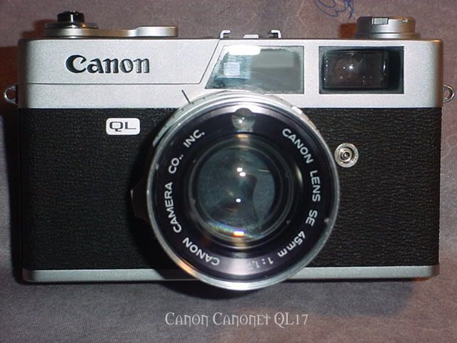

utku, I sent you a PM reply on your question to me. Here is a photo of the camera that I was refering to in the reply.
And a top view,

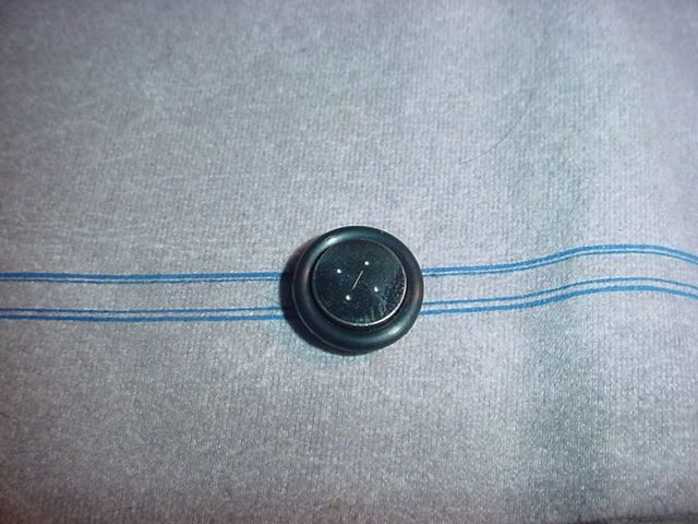

I don't know if these will help you, but here is a picture of the battery with the #9 O-ring, I'm using in my GIII QL 17:

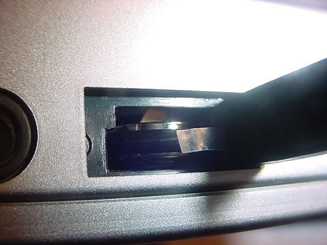

And a close-up of the battery compartment on my Canonet. It is shown in the correct orientation, positive side at the top:
