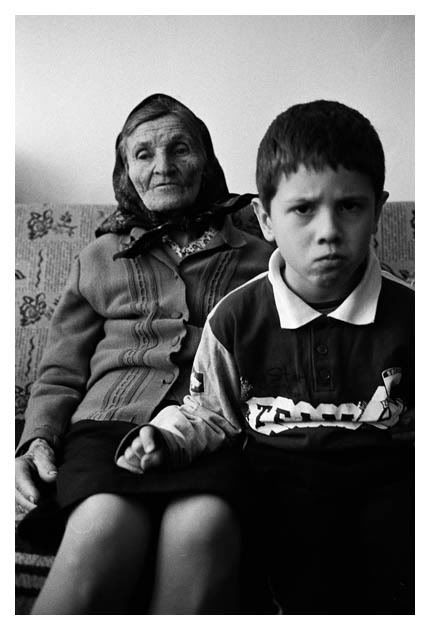

PetarDima said:
Across is fantastic: good contrast, rich with blacks 😉
And that's a lovely example of what it can do! I'm certainly going to shoot some more with it and hopefully get the exposure/development relationship dialed in.
What's the story behind the above image, if I may ask?
Nikhil
