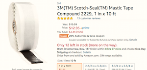

Another great material for general dampening of things is 3M Scotch-Seal mastic tape - it's sticky so just stays where you put it. Once you have some of this on hand you'll find endless uses for it. It's also totally opaque and jet black, so plugs light leaks - all sorts of things. Used to be sold at Radio Shack as 'Patch Magic', for co-axial cable sealant.
