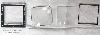

52054208090_d3ba818957_b.jpg - Click image for larger version  Name:	52054208090_d3ba818957_b.jpg Views:	29 Size:	202.3 KB ID:	4783746
Rittreck Six Viewfinder components.
Left to right:
Top securing frame for screen elements;
Condensor lens;
Focus screen proper;
Screen mounting frame.
Cursory examination suggests all of these can go in any orientation around the clock. Umm...no. Not all. If you service one of these: note which way *up* the parts are *and* which edge faces the front.
