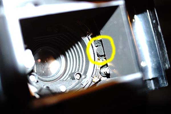

You could start by gently exploring (with a toothpick or such) the interlock mechanism. It's at the left of the lens, as seen from the back, see bottom photo in the first link above.
The lens of my 35 LED can´t be collapsed without cocked shutter.
I would start with pressing the rewind knob, if possible. This might set the advance lever free.
In my 35LED the interlock mechanism sits right by the lens tube, when looking from the back:
When preessing the relesase knob, the little pointed tab is lifted and sets the lens tube free.
