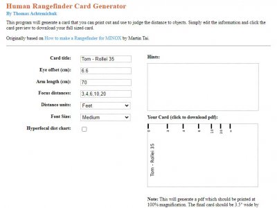

The Human Rangefinder at Human Rangefinder Card Generator
I'm pretty good at guesstimating distance, but I've had a series of these made for certain lenses and cameras.
Just take a couple of measurements and enter them into the online form then add the distances on the focusing scale. The result is pretty accurate. Better than guessing.
If you check the hyperfocal distance box, it prints a scale for each aperture
