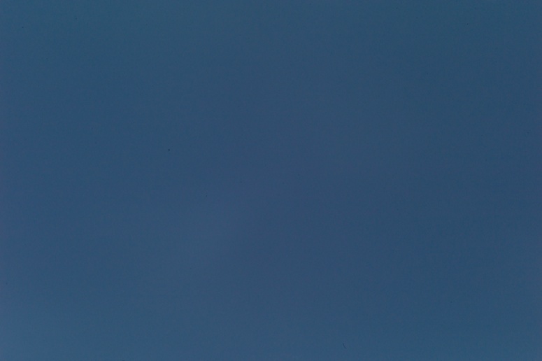

I took the recommended blue-sky shots this AM with my M9 and 90mm thin tele-Elmarit. Both shots are at f/16. The first one is exposed with the "A" setting, for normal exposure:
And this one is underexposed more than one stop, as per the directions:
All I see is a tiny, tiny black spot that I guess could be a dust speck. It's left of center, a little above the middle. Should I still send it for a sensor clean and check?

If the sensor has been replaced, Leica will have the serial number on record. If you can shift the spot it is dust, if you can't, it might be corrosion. If you are not sure, send it in.

I found that making large prints revealed my corrosion. Even on an dimmed down EIZO the brightness of the monitor did not reveal the artifacts or make them abundantly apparent, and of course not all prints displayed artifacts. I only thought I had corrosion because I print a lot and I tend to print big, but over time the locations of suspected corrosion became evident and consistent in location. Know that I lived with these artifacts over a two year period.
Another thing is that wet cleaning with a Visible Dust system did not improve or change the location or shape of the suspected corrosion. Basically the appearance of artifact was intermitent and depended on the image. I would not feel certain I did not have corrosion by just stopping down and doing the sky test. A simple test is just that.
I am very aware that when using my Visible Dust magnifier that has a ring of LED's to inspect my sensor I could not see any defect.
I hope this is helpful. When in doubt I would just send in your camera.
