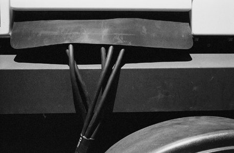

Some double-x @200 examples in stock D23 8 minutes.
1) Tropical house in Brooklyn botanical gardens. Looks like movie lighting.
2) Random street machinery. Full summer 90 degree afternoon sun.
3) Late summer afternoon/evening.
4) Clearing storm, late afternoon, red filter.
