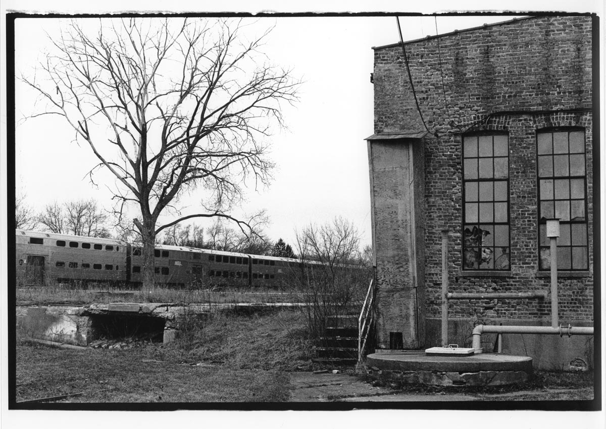

OK a while back I promised I'd post some Double-X pictures, even though they were taken with an SLR (Canon F-1) and not a rangefinder. So here they are. These are scans of real 11x14 prints. I'm also printing Double-X pictures full-frame on 20x24 paper (yes, 20x24!) and they still look fine. The grain is not objectionable at all. I did not expect this, after all the horrific grain I saw when scanning Double-X negs in the past, but there really is something to the stories that it scans grainy but prints nicely. No, I don't know how that's possible either.
I meter at 400 when shooting, then develop in D-76 1:1 for 10 minutes. The negatives are nice and dense, and print very well. I have a bunch of other stuff but these are just 4 random ones I scanned as examples.
I use Shirley-Wellard cassettes, and had issues getting one of them set up for my camera, which is why the sprocket holes intrude on the one picture. That's all been sorted out now...

Nice Duncan - did you agitate every minute on these?

Yes, 68 degrees F, agitate every minute.
I've tried other developer combinations that didn't help with the grain, but that was back when I was scanning the negs. I should pull out that film and try printing some of them, to get a better idea...but I absolutely love the results in D-76 so I haven't bothered.
Oh, full disclosure: I'm actually using ID-11, not D-76. It's supposed to be identical, but just in case it's not, I figured I'd mention that.
