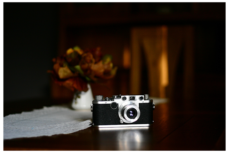

loading up the IId and Elmar combo with some expired Arista Premium. Note the Penny in the bottom plate acting as a film canister shim.
Also debating selling the IId in favor of a IIIf and leicavit combo so this may be the last roll through it.
IMG_0485 by Drew Dulin, on Flickr
