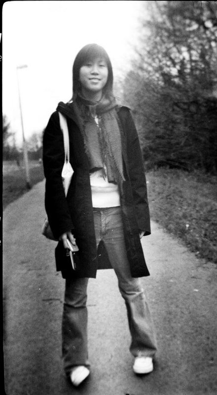

Here are a couple shots from a roll through Ernie today. I fixed the bellows light leak with superglue (at least I think I did, as these photo's don't have the same ghosting as before) and he's sporting the new goatskin from Jay.
Something is wrong with my development of the film I think. The centre is more developed than the edges, like one huge streak, or horizontal vignetting. It's not apparent on all the negs though.
However I could see clouding and discolouring on the neg itself however, so I think maybe I didn't agitate properly, giving uneven development and using exhausted fix.
Anyway. The photo of Kate was quite affected by the light/dark thing, and was also underexposed. I've destroyed it in gimpshop (photoshop alternative) so it appears a bit more pleasing to my own eyes, and a bit more like Kate; originally with the light behind her, skintones appear way too dark.
The other shots are a bit rubbish, just obvious test shots. I like how sharp the Spezial Aplanat lens can be. It's got nice SOFA here, I've left the scan a little less edited, so the tonal range is still apparent.

6x9 images, scanned, Delta-400 (expired) developed in Rodinal 1+50.

I'd bet it's your exhausted fixer leaving a yellow band down the middle of your negatives, which would show up as increased longitudinal density in the scans.
Similar patterns can show up with plastic tanks, the ones that have the twirl rod. If you just intermittently twirl the reel and don't agitate the chemistry enough, the film can come out unevenly developed in the lengthwise direction.
It should go without saying that if you see any yellow streaks or blotches on your film, refix and rewash as soon as possible.
The window placement isn't right for it to be a red-window fault. I didn't see any burnt-in numbers either.
I'm re-fixing now to see if that helps. I'm thinking maybe the development was dodgy though.
