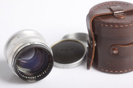

Carl Zeiss Jena Sonnar 5cm f/1,5 T Nr. 2866400

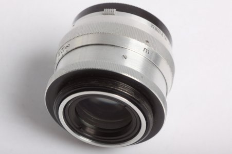

This was offered last year on Ebay. The serial is wrong as it belongs to a batch of Kipronar 9cm lenses. The LTM body has an m mark but it has a dot as aperture mark. So it is no authentic CZJ body.

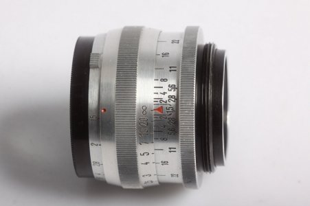

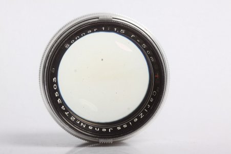

Same serial number of 2866400. But the body is a Contax mount version of this lens. I first thought that someone had remounted the LTM lens into a Contax body but that is unlikely. LTM Sonnars go for more money. So this would be of no profit.
Both bodies belong to the time of 1945 though. You can see the age of the lenses. They are unique items. But I suspect a moonshiners job here.
These are most likely made after the war ended, and made in Germany. I have seen a lot like this. The LTM mount looks authentic, but the only way to know for sure is to open it up and look for the serial numbers Stamped on the individual pieces. The lens- look for the SN engraved on the rear triplet. Also look for any taps near the barrel to hold the rear triplet in, and (rare) the name ring in. I've seen ZK lenses with the hole in the barrel for the set screw, but it not used.
Interesting observation. I suspect that these are both what Sonnar B and others refer to as "irregular production" lenses. If one gives credence to the idea that these kinda lenses were clandestinely assembled by CZJ workers using stolen parts, it would be reasonable to believe that double serial numbers would occur, given that people making black market products are not going to be coordinating on details like serial numbers. The lenses look mostly OK, but have differences like the dot for the aperture index and the wider than normal ears on the aperture ring. I recently saw a similar situation on eBay for the 8.5cm f2 Sonnar, same serial number on two different lenses, one in LTM and the other in Contax RF mount.
Also note the number of Ridges in the Aperture ring "Wings". More than the wartime lenses, more than ZK Sonnars and early Jupiter-3's.
These are made-in-Germany Sonnars, "irregular production" with a best effort after the war left Germany in ruins and the Soviets were occupying the Eastern part of it.

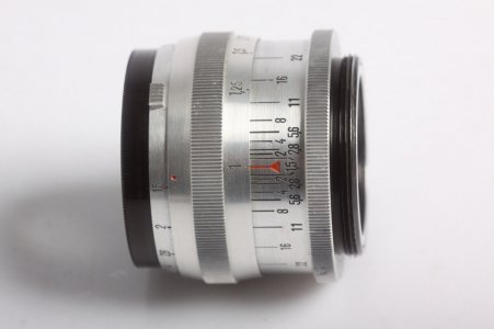

The interesting thing about this fake is its unique LTM body. The aperture scale and focus scale move in Leica direction and not the usual Zeiss direction.
A very strange ebay "special" that initially almost passed as a legit LTM wartime Sonnar -- until I started looking more closely.
  • What's going on with the anodized mount section - strange but not the strangest thing I have seen
  • The black nose is also rare but I have seen legit examples in the 2.84x range with it
  • It gets weirder there's the flat-head counter-sunk screw apparently holding the lens into the mount - it looks very close to those used on the 5.8cm "Leica Sonnars" and some 8.5cm LTM lenses out of the same workshop
  • Then you realize that the focus scale ring has no delimit screw (strange) and seems to be fixed to the inner focus mechanism with only one single grub screw
  • Lastly and the strangest of all - the aperture dot is on the focus scale ring, this means the front has to rotate otherwise that makes no sense at all
  • Otherwise the lens is unremarkable, the aperture grip looks correct, so is the font and the general style of engraving are all within the typical variances
Very strange construction... and almost certainly not original
Edit: To be clear, I am quite certain that if disassembled, the optical block will turn out to be 100% Zeiss... the mount portion however... who knows. Irregular production, most likely.
