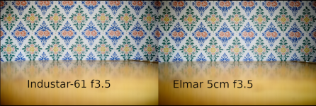

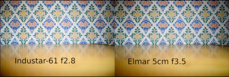

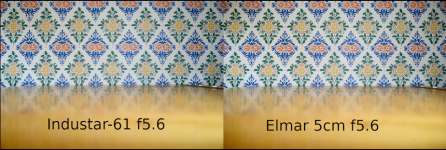

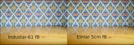

Since then, I've worked out a faster and more easily demonstrable test - something you can do at home. If you set up a close-focus test using a vertical object with a flat plane and strong contrast - I have an old cultural theory book that's perfect for this - and measure 1m from the object (i.e. the front cover of said book) to a Leica's film plane, you should be able to focus a Leica lens and get the RF and focusing ring to match, confirming a perfect 1m; you might have to move the tripod laterally slightly to get everything to line up right. Once it does, you're set, and you've got your control. Now change the lens for a Soviet one (without moving the Leica, obviously), and try focusing with the RF; when the images in the RF align, look at the focusing ring, and it'll be at roughly 1.1m, suggesting a back focus of approximately 10cm. Replace the Leica with a FED or Zorki and a Leica lens, and you won't even be able to get the RF to line up with most LTM lenses; my Elmar 50/3.5 hits the close-focus stop on a FED 5 before the images align, and a 28mm Voigtlander Color-Skopar lands at 0.9m when focusing with the rangefinder at a 1m distance, indicating a front focus which nicely mirrors the 10cm measurement on the STM-on-Leica test.
To me, this definitively proves there's a systemic incompatibility here, regardless of how much some people continue to suggest otherwise.
