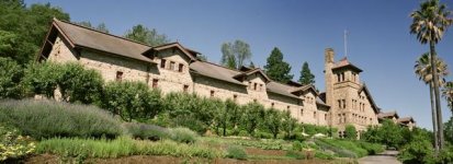

This is a manually stitched panorama made from 6 separate shots using my Mamiya 6 and 50mm f/4L lens. Click on the image for a larger version.
I used the same shutter and aperture settings for each shot. I can't remember the f/stop but it was probably at least f/8. I can't remember any vignetting issues, although I suspect I removed the hood first.
