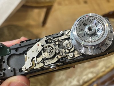

Thank you so much Mr. Rick and Alen I made it. I lubricated the first curtain shaft. There is no capping✌🏻 But I bulb mode doesn't work😔 shutter fores very fast on Bulb mode. Do you have any advice for it?
