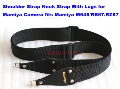

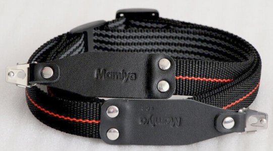

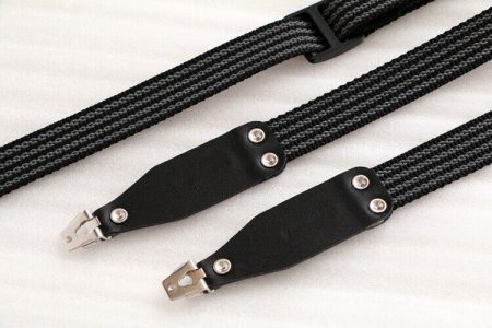

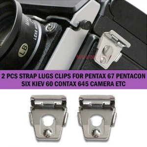

Thanks to everyone for the replies and info. I have searched ebay/PicClick UK (a quicker way of searching ebay with all the pics on one page) and saw plenty of straps going for £69 - £85 ! Anyway, there area couple of Chinese ones going for £28 - £30. I'm a little puzzled by the fitting on the Op-Tech strap that is compatible with Mamiya having a squared-off bit on which the camera rests when the narrower part of the lug being round. I'm also not sure about the plastic clips that hold the padded part to the narrow part, seems like a weak point to me. Anyway, here's two of the Chinese straps, If anyone knows which metal bit is "best" let me know. To me, the one on the left looks weakest, although the strap is wider. Also, I see that the metal "ends" are available on their own, are they worth getting and putting onto a strap, or would the thinness of the metal wear away the strap quickly?:

Thanks to everyone for the replies and info. I have searched ebay/PicClick UK (a quicker way of searching ebay with all the pics on one page) and saw plenty of straps going for £69 - £85 ! Anyway, there area couple of Chinese ones going for £28 - £30. I'm a little puzzled by the fitting on the Op-Tech strap that is compatible with Mamiya having a squared-off bit on which the camera rests when the narrower part of the lug being round. I'm also not sure about the plastic clips that hold the padded part to the narrow part, seems like a weak point to me. Anyway, here's two of the Chinese straps, If anyone knows which metal bit is "best" let me know. To me, the one on the left looks weakest, althought the strap is wider:
The one on the right is exactly what I have. Well made and quite secure.
I would go with the ones in the far right photo...they look like the original ones I have...the post on the camera is about 4mm wide.
They also allow you to put the strap of your choice on the camera.
nikon_sam, I presume you mean the separate strap lugs? They do look reasonably solid, and I am tempted, but I'm not sure about the thin horizontal bit the strap threads through. I'd be a bit less worried if the edge of those bits were rounded. On the other hand, the strap ends of "strap 2" do look a bit more sturdy. On the other hand "looking sturdy" is no guarantee. Bah! If only I wasn't such a "ditherer". On the other hand (Err, just how many hands have I got?) deciding quickly hasn't always turned out to be a good idea.
nikon_sam, Thanks for the extra info. I may just get the strap lugs and then spend a lot of time looking for a strap that looks strong enough. lol.
