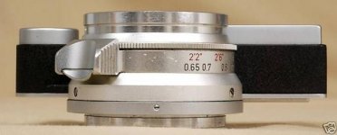

Thanks for all the good info. But I'm a bit puzzled with my Summaron, which has an "early" s/n 1666xxx with a single small setscrew, and the red dot on the same ring as the setscrew. I had assumed it was a straight M-mount, but now I'm not so sure... Pics:

I also assumed that mine was a fixed mount. It's 0.7m with a teeny-tiny setscrew on the back mounting ring (I just noticed). Serial #1615868. Mine has the red dot, and so I just removed the rear mount. Which was a good thing, since I could clean it a bit, before putting it back together.
Doug, your's is an M3-type. Although it seems to have the set screw, I don't know about these. The story here applies to M2-types. I assume the goggles would interfere with mounting on LTM cameras. Sorry.
Ah, true, true; there's no earthly reason for a goggled Summaron to be screw mount, as the goggles aren't spaced correctly for any screw-mount Leica. M-application only. Thanks!
Mine s/n 1665555 is the same as Doug's, the red dot is on the body of the lens and there is a small screw on the same ring, but there doesn't seem to be a chance to unscrew it. So that story applies to the M2-types only, true. It has a wider threading btw. Superb lens, though.
