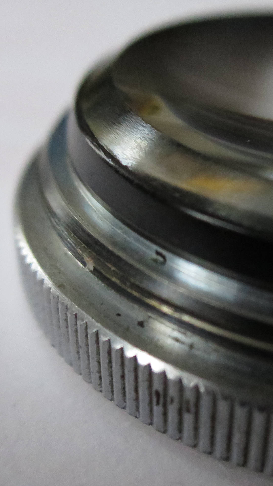

I'm new here. I have the same lens with a similar problem. I also got the front pair off, the rest of the lens is impeccable. it seems as if the the small dark metal ring seen from the back is retaining the lens pair. any ideas how to get it off? is it threaded?

In the Summar and Summitar the elements and groups are peened into their mounts. That is, the metal part was turned on a lathe with a thin metal flange sticking out. The element or group was put in, and then the thin flange was bent down (peened) over it. To get the element or group out, you have to chuck the metal part in a lathe, and cut off the peened-over edge.

I understand about peening. but in this case the black metal ring is conical, the wider side is towards the chromed metal part. it looks more as if the couplet has been inserted from the other side into a slightly crimped conical ring and then lens and ring have been fixed to the chrome part.
peened or not, another question arises: how is the black metal ring fixed to the chromed metal part?
I have made a close-up of it:
anyway: suggestions for a pro to do such work at reasonable prices would be welcome. I live in france.
