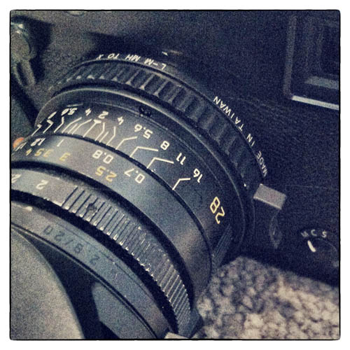

I have some unknown-brand adapter that came with my camera which works just fine. But I also just got the Hawk M-X adapter which adds a focussing helicoid to the mix. Now I can focus that 28 'cron down to a few inches.

After playing with them for a bit - not really the greatest lenses for an xp1 since they make it so big, so I jumped in the water and bought a Fuji brand adapter and a used Leica 28mm emarit lens - it's great - I like the size, focal length and obviously the image quality. I use it on the street quite a bit.
