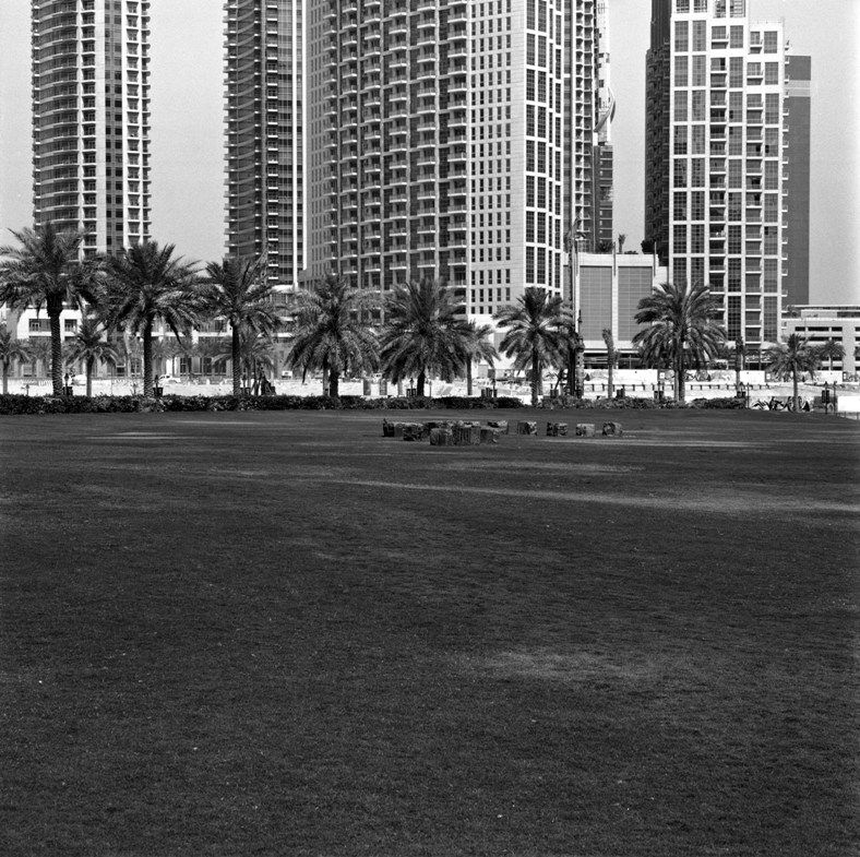

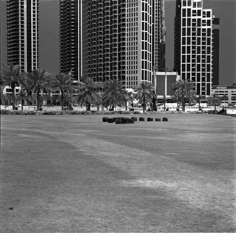

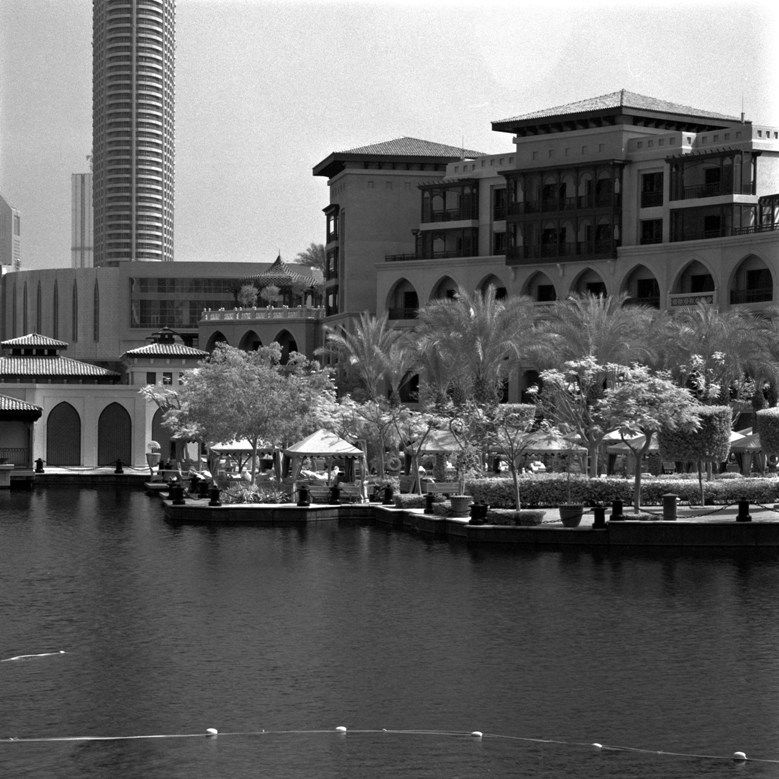

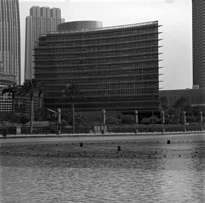

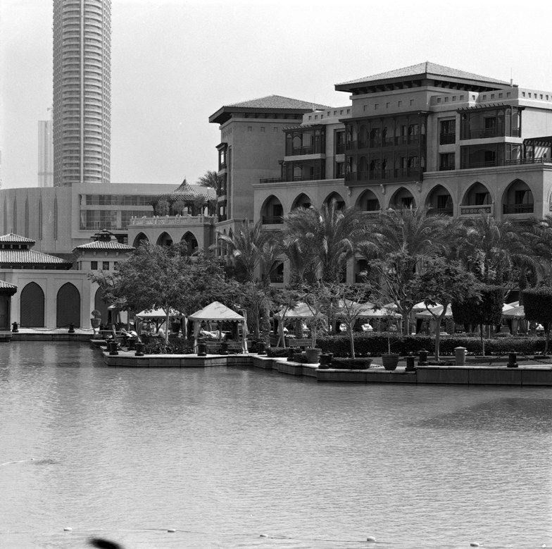

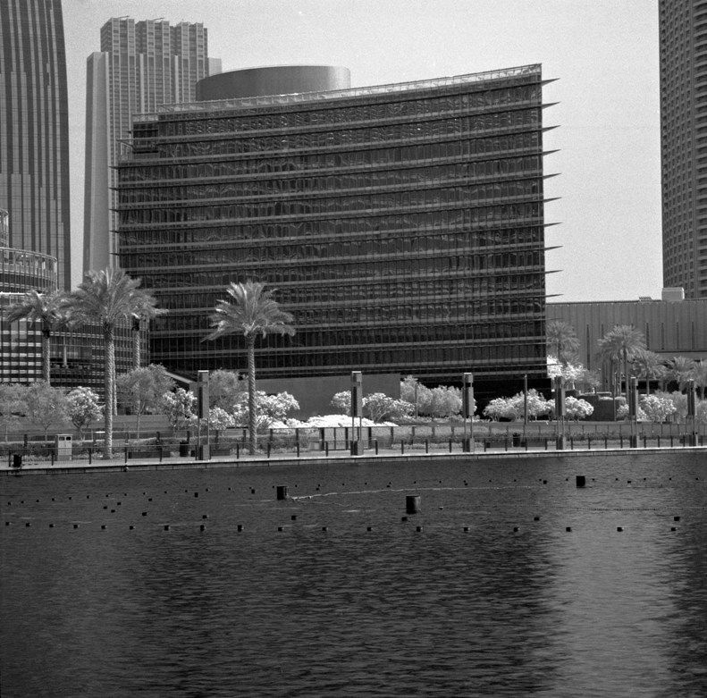

I shot a roll of SFX200 to test Wood Effect and get an idea on correct exposure and development. Ilfosol3 @ 6 minutes, 3 scenes shot at ISO200 without filter, and EI 12, EI 6 and EI 3 with Hoya IR72 filter. I scanned them and EI 6 looks best, but I won't know which is best until I print in the darkroom. I know some get best results as EI 12...
So here are what I got. Nice Wood effect with SFX200 is easily achieved! Three examples shot "normal" compared to EI 3 / Hoya filter. Shot on Mamiya 6 / 150mm, Downtown Dubai, UAE. I my working my way through some Rollei Retro 80S for the same exercise.
