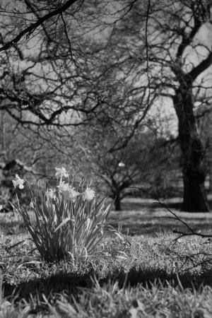

I found an old Zenit 3M lying around with an M39 Helios-44 on it. On the Focoslide, you get full focusing to infinity, and the pre-set diaphragm is incredibly useful. This was at f/4, with a Canon IIIa mounted in the Focoslide - that's usually a good slave body for this setup, as I absolutely hate using the combined RF/VF in that thing.
One from last weekend:
I think this is the first time in over ten years I've gone "huh, I wish I was still shooting Velvia 50". Also, I'm continually amazed by the amount of detail a 1950s 90mm Elmar can render as a macro or semi-macro lens.
(Leica Ic, 90mm Elmar, Fomapan 100 in Rodinal, Focoslide)

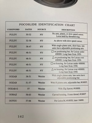

The most difficult part of the whole process is sourcing (and understanding) all the different adaptors and widgets. I finally found a ZWTOO-HESUM for a decent price the other day - that's an adaptor that supposedly couples to the bayonet of a Summar's collapsing barrel to enable focusing between 42cm and infinity, so I can use that on the Focoslide instead of the Helios-44. There was also a ZWTOO for the 50/3.5 Elmar, a ZOONT that was the same but for very specific Elmars, a ZOOXY for work between 23cm and 1m with the Elmar, and even adaptors to use a Focotar enlarging lens (which could be interesting).
The thing that you have to watch out for is that all of these are for the earlier LTM Focoslides; the M mount one has a larger 51mm lens mount, so doesn't take LTM lenses directly and needs a different set of adaptors (VSPOO for Summicron, VXZOO for 50/2.8 Elmar, VXOOT for 50/3.5 Elmar).
Apparently they also made one Barnack-compatible Focoslide with that 51mm mount, but they (thankfully) seem fairly rare; the direct LTM option is a lot more interesting (and fun).

I should also note here that it turns out the ZWTOO-HESUM does not give you focusing from 42cm to infinity on a Focoslide - I'd have to measure to check, but it's more like the 23cm to 1m distance given for the ZOOXY. Still quite useable, but not even close to what's quoted in the "Leica Accessory Guide" over on Butkus' camera manual site. I think that's a mix-up with an earlier adapter made by Leitz New York that, according to a book/pamphlet on close-up photography, has a "compensating ring" that can be removed to allow for infinity focusing. The later Wetzlar adapters don't seem to have that, as far as I can tell.
