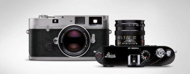

The new Leica MP: The closest New M thing to an M3 you can still buy brand new
Dismissed by one wag as “the new minimalist traditionalist camera with ridiculous film rewind knob to fool Leica minimalist snob buyers” the current Leica MP (not to be confused with the rare limited-edition pro photojournalist Leica MP of 1956-1957 or the discontinued 24 MP digital Leica M-P, Type 240) is really a very adept 35mm rangefinder camera that’s basically an “M3-ized” M6 with a 6-frame line finder and other cool features. Retro components include brass top and bottom plates, a classically contoured solid forged film wind lever, an M3-style frame line selector lever, and the previously mentioned rewind knob. On top there’s that Long-L Leica script logo, on the back the traditional hinged flap and bottom loading system has been retained, and the camera is compatible with the Leica Motor-M, the Leica Winder-Mm the motorized Winder 4-P and 4-2, and the Leicavit trigger winder.
Current Leica MP in chrome (left) and black, both with 50mm f/1.4 Summilux lenses. With M6 features and M3 style, this built-in-meter M is a modern classic.
The MP’s bright line finder displays auto-index frame lines in 3 groups of 2 depending on the lens in use—28 and 90mm, 35 and 135mm, and 50 and 75mm. It was in initially available in finder magnifications of 0.58c, 0.72x, and 0.85x, but now only the 0.72x version is now being sold. It employs a silicon cell TTL metering system that reads the light reflected off a 12mm metering spot on the first shutter curtain, which corresponds to 13% if the full film format. LED readouts coupled to the aperture and shutter speed are used to set the exposure Except for the metering system the camera is entirely mechanical, with a cloth focal plane shutter providing shutter speeds of 1-1/1000 sec plus B ( the latter also serving as a meter off position) and flash sync at 1/50 sec or slower. The MP is currently offered at $5.695.00 in black or silver, and if you want essentially the same camera without the meter, opt for the Leica M-A and save a blistering 100 bucks.
All Leica M cameras, whether analog or digital, are glorious anachronisms steeped in mid-20[SUP]th[/SUP]-century technology and defiantly old fashioned—just like, say, a Harley-Davidson motorcycle or an Airstream trailer. The wave of the present and future is destined to be dominated by mirrorless cameras that don’t require separate optical finders with elaborate mechanical frame line systems to achieve accurate viewing with any lens, and they provide far greater framing precision. On the other hand, the classic M range/viewfinder still has its charms, is a joy to shoot with, andstill has a few tricks up its eyepiece, like letting you preview the effects of switching lenses or the ability to track a moving object before it enters the frame. That, and the Leica mystique, and the unsurpassed quality of its breathtakingly expensive M lenses are likely to propel the Leica M forward into the remainder of the 21[SUP]st[/SUP] century without breaking a sweat. And of course, Leica has also embraced the mirrorless camera in several formats and is poised to release the Leitz Leica Phone 2, an Android smartphone with a 43MP 1-inch sensor and a Summicron lens! Indeed, according to Leica, they’ve just had the most profitable year in the company’s history, and you don’t achieve that by merely recycling timeless classics.
