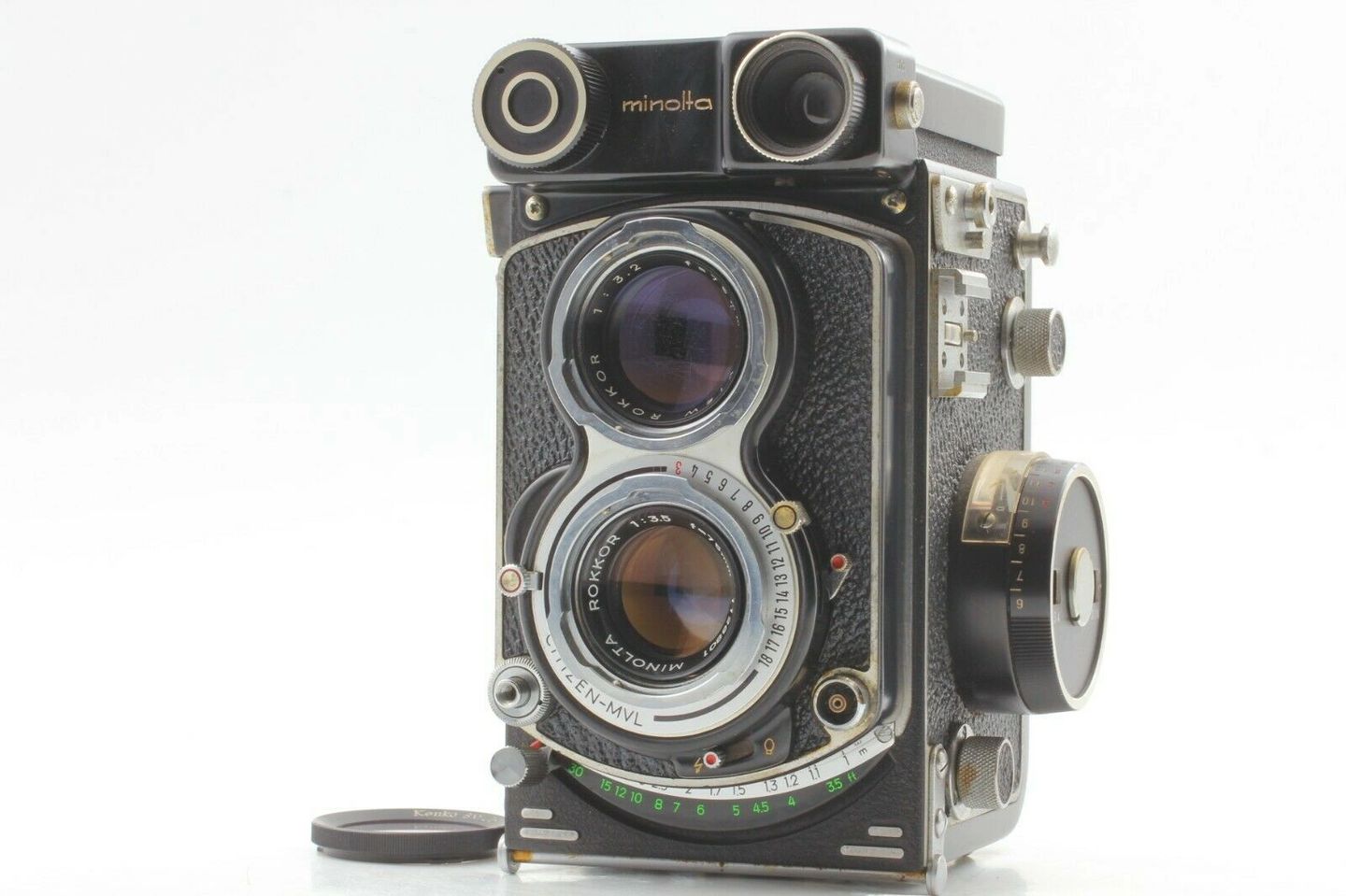

Minolta Autocord with 75mm f/3.5 Rokkor lens and Citizen shutter
Minolta Autocord: Often referred to as “the second best TLR ever,” it was surpassed only by the class-leading Rolleiflex among non-interchangeable-lens models. The Autocord was produced by Chiyoda Kogaku Seiko K.K. of Osaka, Japan, commonly known as Minolta Corp. from 1955-1966 in well over a dozen iterations. All feature crank wind, semi-automatic loading (auto frame positioning and counting after initially aligning an arrow on the paper backing) a 75mm f/3.5 Rokkor taking lens (a highly esteemed 4-element Tessar type), a full range of shutter speeds down to 1 sec, and a double exposure override button that let you turn the crank backwards to cock the shutter without advancing the film.
A defining feature of the Autocord is the helicoid focusing lever, which is mounted below the lens board where it can be operated by either hand, so you don’t have to shift hands to wind the film. However, while the rest of the camera’s metallurgy is first rate this lever is made of brittle pot metal, is vulnerable to breakage, and is virtually impossible to fix. Make sure the focusing lever is intact before you buy one, don’t force it or subject it to impact, and you should be OK. Also, the Autocord incorporated several different shutters over its long production run and the ones with Seikosha or Citizen shutters are preferable to those fitted with Optiper shutters, which are somewhat less reliable and harder to fix. It’s not a deal breaker, just a suggestion if you have the choice. Finally, the Minolta Autocord was offered in several versions with built-in, uncoupled, transfer-the-setting meters. Selenium meter versions like the Autocord L are fine when they’re working but virtually impossible to fix if the meter cell goes bad. CdS-meter versions like the Autocord CDS III have less delicate meter mechanisms but were designed to use mercuric oxide calls and will have to be modified to accept currently available equivalent alkaline or silver-oxide batteries.
rs=w:1440,h:1440
Minolta Autocord CDS lll
Bottom line: Minolta Autocords are great cameras, but they’ve gotten pricey over the past few years. You’re probably safer to opt for a meter-less model, but if you can get a clean functional Autocord with a working built-in meter at a good price, go for it.
