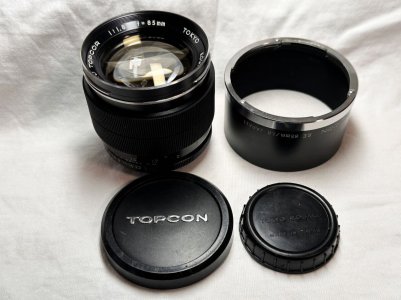

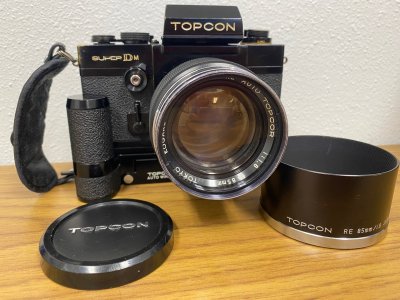

Found this highly sought after Topcor RE Auto 85/F1.8 with original lens hood and in Mint - condition to use on an RE Super I've had for years.
Along comes this pretty much like new Topcon Auto Winder which even though it's black, I thought would still go nicely on the silver RE Super.

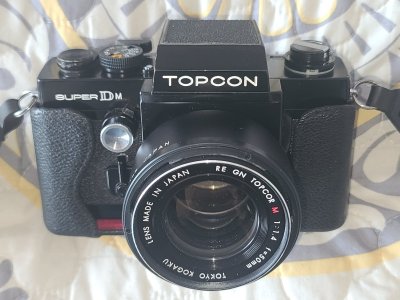

Little did I know, the Auto Winder was basically designed for the Super DM, and without an electrical contact on the bottom of the base plate, it wouldn't work on the RE Super. So, not wanting to give up on such a nice piece, I had to look around for a Super DM. This camera body has seen some experience, with just a bit of brassing to the black edges and just enough small scrapes to make it look like it had been used but not abused. The bonus is the meter is right on and the focusing screen and view are pretty clean. This combo was not cheap and I shudder to think how much $$ I spent, but I know down the road, this piece is only going to increase in value, especially the rare lens and hood combo. I thought my Contarex Bullseye was heavy, or my F2 with a 55/1.2 Nikkor, but this baby is a real HEAVYWEIGHT!
