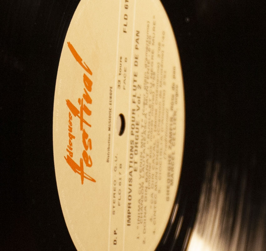

I don't have both to compare how this copy is back focusing compared to the other. In some cases it is ok but in most it is not optimal.
I just did a little test to see how it works with my M9.
I took 20 pictures with each lens wide open of this record at very different angles, hand held (1/180s), always focusing on the hole and this at about 1 meter away.
Maybe not very scientific but it gave me some informations:
With my copy of the Summicron v2 it was sometimes very slightly front focusing but in most of the cases this was ok, like this:
Same for the soft Summilux 35 pre asph:
The Summicron 50 v4 was always right, like this:
And the Ultron:
Now I don't know how disturbing this is in "real life" , maybe not that much, maybe more..
Ps: don't pay attention to the light, it was very overexposed and I had to darken the pictures a bit in order to see some details.
That's a bummer. Judging from your pics, focus can't be off by much.
But two out of two... I'd be more suspicious of the camera than the lenses. Can you get your RF checked somewhere?
Or pack up all your lenses and camera and send them off to DAG 😉
I'll try the Leica store in Munich tomorrow. Maybe I could even test the lens on an M240 or M10..
I could also try to live with the lens working like this, it may give me some nice pics..
Thanks for the additional photos and looking forward to the comparison shots. I was just in Munich in February and had ~5 days of sun and nearly 15 degrees. Nice to see the blossoms blooming!
FWIW, my copy of the VM 35/1.7 back focuses a fair amount on my M240. But it's consistent, so I just offset the rangefinder alignment by an amount I determined after many test shots. I can hit correct focus as consistently as I can with any of my other M lenses. The M240 was recently overhauled by Leica and the RF was recalibrated, yet the misfocus with the VM remained. The camera's RF works nearly perfectly with most of my other M lenses, but if I'm extremely picky shooting wide open, some of those also require slight tweaks, usually to offset slight back focus.
It looks like your 35 Cron and 35 Lux slightly front focus. More so the Lux.
