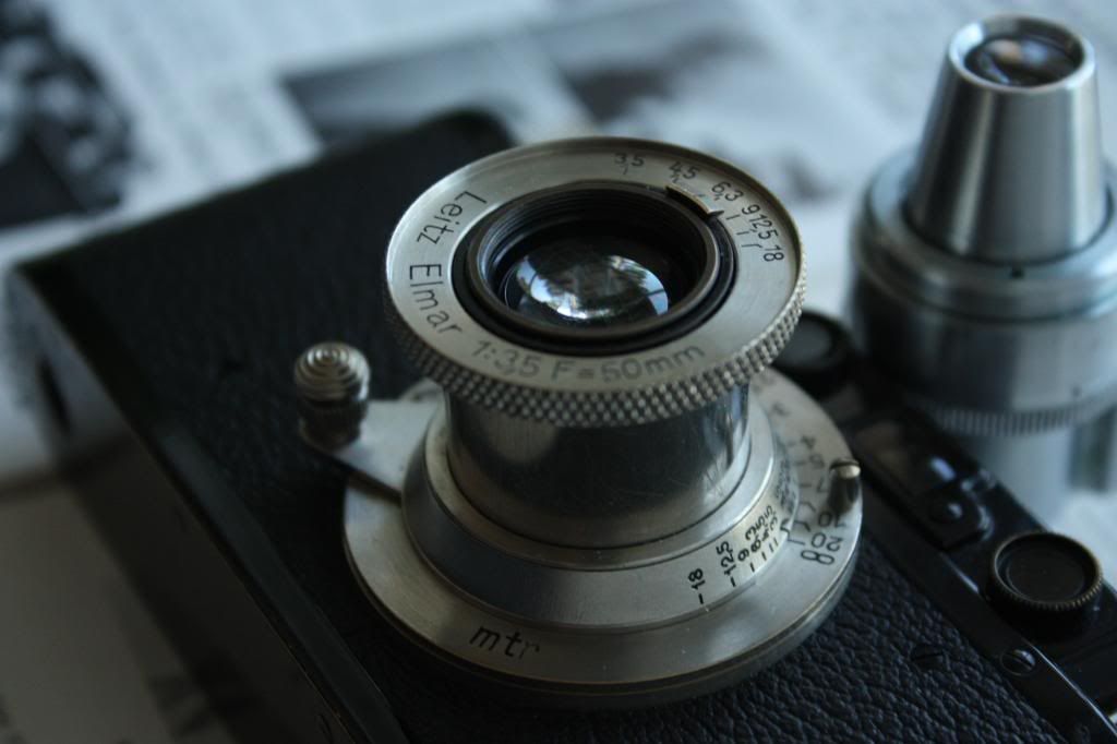

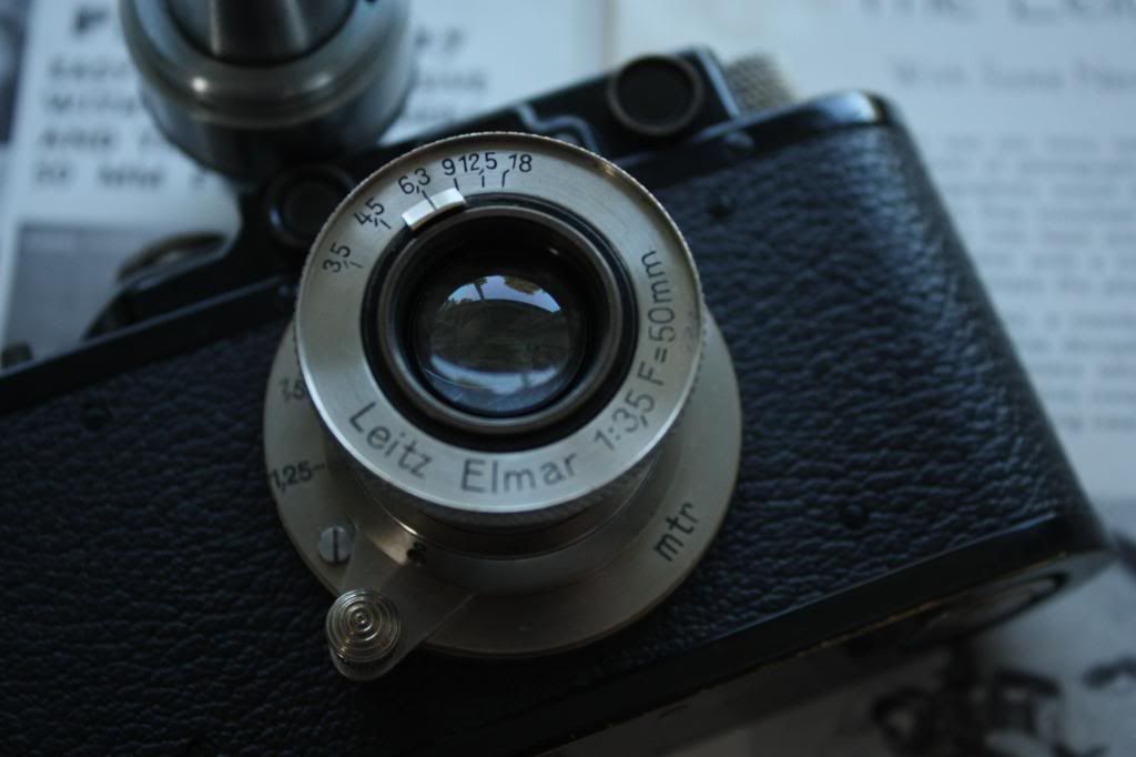

I got my first developed negatives from my 1929 Leica II today! I have scanned some of them and here is one of the pictures. I used an unumbered Elmar 50mm lens on Kodak Color 200 ISO. It looks like if the picture is taken with an older mobilephone-camera. However, I have an older scanner which might not be the best to scan negatives. The 50mm has a lot of light scratches in the middle of the objective. I have another shot where I have used a 90mm Elmar (my other lens)
First Pic: 90mm Elmar (1933) - Nice lens without visible scratches.
Second Pic: 50mm Elmar (unumbered) - Lens with several scratches, but not very deep scratches.
Is it possible to repair the 50mm with the scratches? Polish?
Shine a flashlight in one end (not directly into your eyes) while you're looking at inside from the other end. I wonder if you'll find that there's a lot of fogging, internally, in which case a good cleaning might help.
You have sidelight falling aross the front surface of the leans. If you can't see obvious fogging when you shine a light through it the lens is probably not that bad. I get alarmed when I shine a light through even a well performing lens because there's usually all kinds of cr** in there but it doesn;t necessarily show up on the negative. I am pretty sure you will be astonished at the improvement a simple lens hood will make.

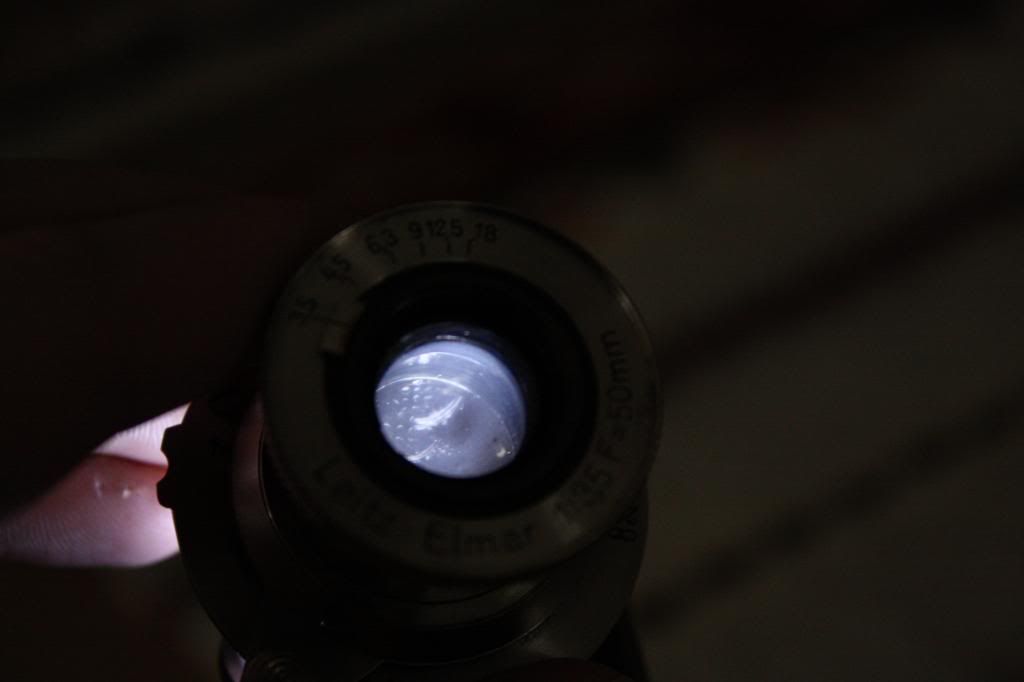

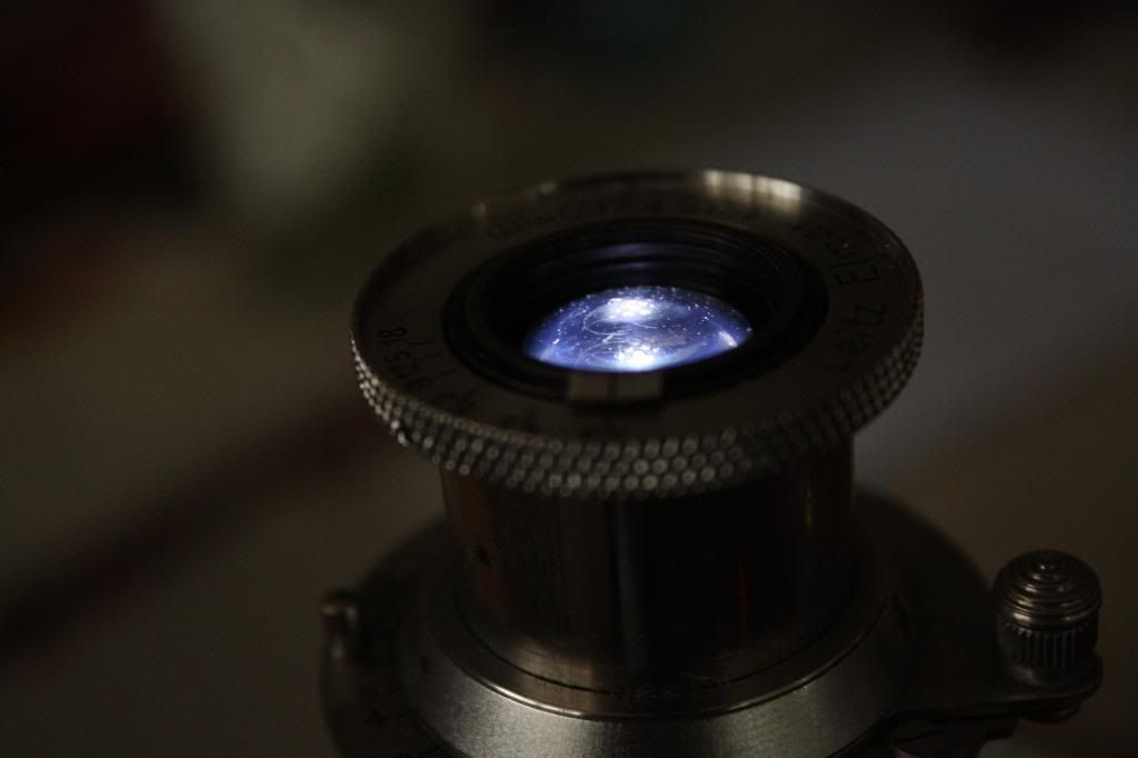

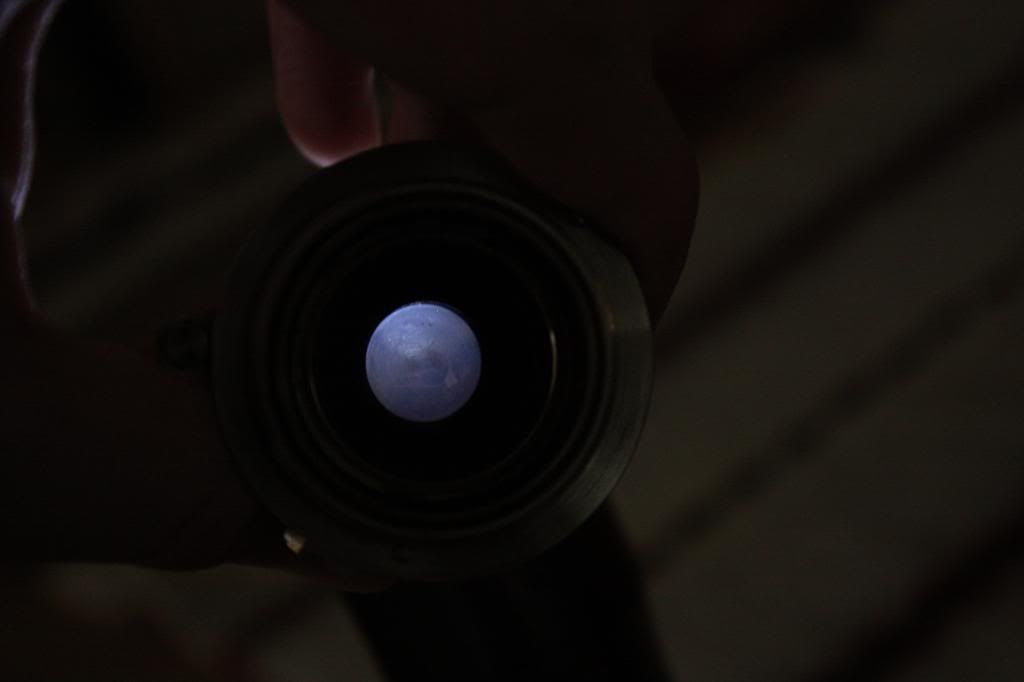

I tried the flashlight test again, now I see it's a bit moore fogging than I saw yesterday. Here are some pictures of the lens:
What do you think? What should I use for cleaning?
That is internal fogging and you cannot clean it out yourself easily unless you know how to handle a prewar Elmar.
Good news is, if you do know how to (dis-)assemble a prewar Elmar, cleaning should be easy since there is no coating to damage.
There's more to it than just (dis-)assembly, it should likely be fine-tuned to correct specifications afterwards too, or you will still have out of focus photographs.
Generally, this is a repair persons job to perform, not a Do It Yourself kind of job.

Thanks for your answer! I do not know how to disassamble or clean the lens! What should I do? Learning by doing? or Get an expert? I do not know about anybody who can do this in Norway!

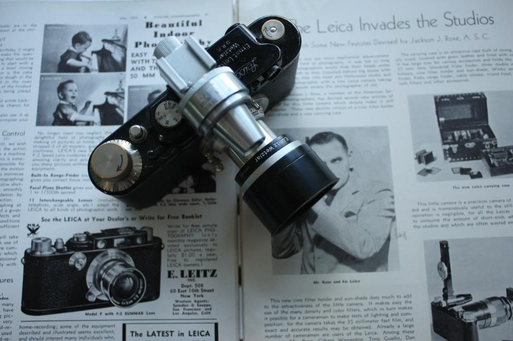

Okay, thanks for your kind respons! I hope so too. I got the Leitz lens hood - FIKUS, which can take lenses from 3,5 up to 13,5.

Your Elmar will have a new lease on life and will produce much better images! Still, get a lens hood with it to further increase image quality!
