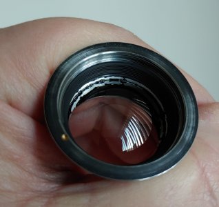

Brian, I actually did some partial outer touch ups with a black paint and now it looks perfect (see attached) however when I look through the glass I still can see some paint loss and I don't understand where is it? Looks like it's somewhere inside. I've seen it on many Summar lenses. Any idea how to get there?
I'll take a look at my not-so-good Summar, if the glass comes out of the fixture. It looks like the paint loss is between the glass and the metal of the fixture.

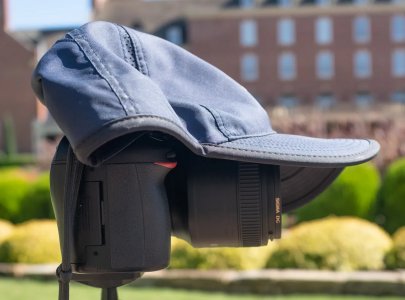

I could not find a Baseball Cap marked "Summar", but the hood is. I would not know which baseball cap to wear with the lens, but I do know what hood to use.

I think that was an idea using baseball cap as a hood shade neal3k mentioned about (see attached). Image is not mine, I downloaded it from internet, some photographers really practise this method.😃
I have had that happen when I applied new black paint over the old degraded one.
My theory is that the old paint has bubbled up underneath and when I (or you) apply a new layer we're not doing much because the problem is underneath. Sadly the only solution I have found is to completely strip the old paint and do it over.

Oh, I see it now... Looks like "Schneideritis" on old LF Schneider-Kreuznach lenses, no affect on image quality except flare. I'd probably avoid to pill off that paint myself, can do something wrong. Thanks!
