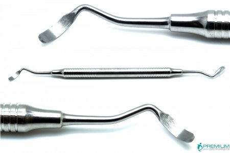

For the other non-water-soluble paints I use a dentists tool and slowly chip away at it. Messy and time consuming, but sadly I don't know another way that would not endanger the lens. To repaint the lens I use water soluble calligraphy ink which dries as a very dark very textured (read: matte) black.
The tool in the middle. It has no sharp edges so you don't risk scratching the lens as much.

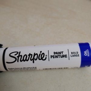

Haven't tried with wet tissue yet (just water?) But rubbing alcohol 99% was useless... Will try with lighter fluid. Thanks a lot for the info! Now I have to order some dentist tools. I did some touch up with oil based Sharpie, works well, opaque and solid, takes some time to dry.Be careful with alcohol as for cemented elements it can get in between the lens cement and can cause trouble. Naptha (lighter fluid) is a bit gentler and has less capillary action, but you still have to be careful. Often these paints are water soluble for that reason. Have you tried a wet tissue and simply wiping it off?

I use paint based "sharpies" quite a bit or various jobs - as an aside, including wear marks on the exterior of black lens bodies though it's not terribly resistant to wear it works as a touch up but sometimes needs reapplication. I think the ones I am familiar with are the same composition as the oil-based ones you showed though the pen itself looks different (having a metal barrel). Mine is labelled "Uni Paint" which I think is a Japanese brand.Haven't tried with wet tissue yet (just water?) But rubbing alcohol 99% was useless... Will try with lighter fluid. Thanks a lot for the info! Now I have to order some dentist tools. I did some touch up with oil based Sharpie, works well, opaque and solid, takes some time to dry.
