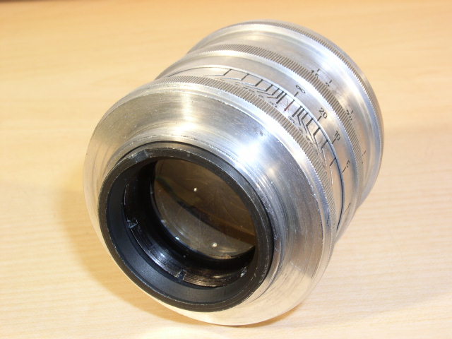

Hi, I'm unearthing this thread because I just found a strange Sonnar in Contax mount. However, I'm in vacation and I do not have access to the lens itself or to my Contax related books.
This lens is from a German collector who, in the 1970s, checked the focal length because it was bigger than a normal Sonnar. It was found it is close to 60mm, even if it is marked as a 5cm lens. It has also six spanner slots in the rear.
The serial number is 3 14X XXX, consistent with a 1949-1951 build date. It looks like this :
Compared to a regular Sonnar, it is taller :
Could this be one of the 50 postwar real lenses mentioned in this thread?

It will be difficult to get the Sonnars 58-60 mm declared genuine Zeiss. Yet there are good reasons the Sonnars 58-60 mm lenses were designed just before, during and after WW II. The simple fact that the SLRs 35 mm developed in the same period (Dresden, Jena) needed a fast lens and the Sonnar could be that lens but with a slightly longer focal length. In the end the development of coatings in the same period allowed the use of Planar and other double Gaussian types of shorter lengths so the Sonnar design was no longer needed for that purpose. I very much think that the 60mm glass we see in LTM mounts etc was originally intended for SLRs prototypes and not for Contax or Leica RFs. Whoever did mount them in brass or aluminium for RF use is another question. I have a brass LTM version here.

A Takumar for SLR based on the Sonnar design is the 58mm 2.0. It simply is impossible to build a 50mm Sonnar for 35mm SLRs.
My bet is that all the Sonnar glass with an odd focal length between 57 and 60 mm were aimed at SLR use. It could be that only the glass was ready when Zeiss decided that the Planar, Biotar lenses were more suited for SLR use. They made a lot of progress with coatings in that period.
