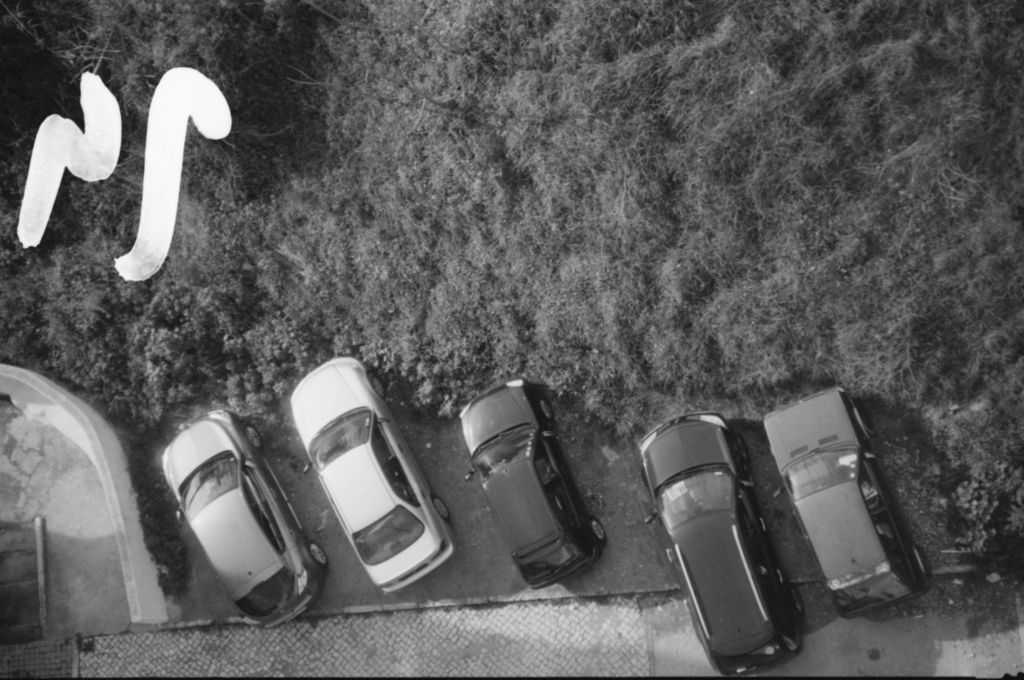

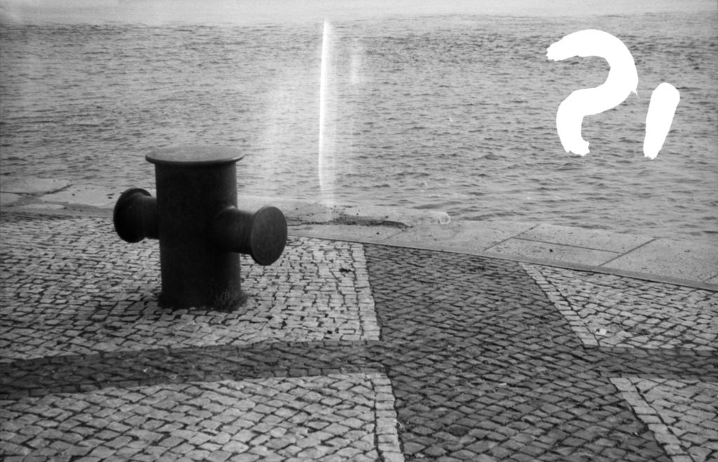

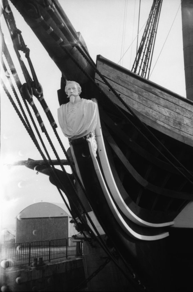

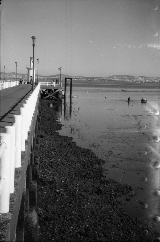

I was testing a “new “ Olympus Stylus Epic and I found these images after developing hand-rolled Orwo UN 54. Those circles near the edge of the frame are regularly placed and are visible in only some frames (mostly in the pictures taken under sunlight - but not against the sun). There are obvious lightleaks, please ignore them. It’s the circles that puzzle me.
Can you sugest any explanation for those circles ?

they look like dirty transport rollers. I typically see this with cheap drugstore C41 processing machines. I realize that this isn't a C41 film.
Sometimes you can wash it off.
Did you process this yourself?
Could they have been preflashed onto the film during the "hand loading"?
Curious, it really does look like a roller of some sort with little nubs.
I remember getting something similar when I used a development tank with apron (Kodacraft) back in the early 70s and I did not fill the tank fully up with developer and used uneven agitation.

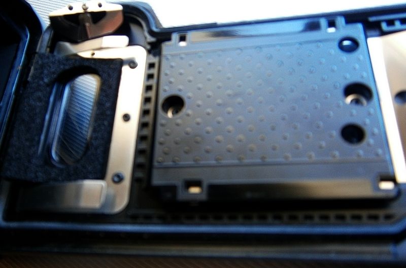

I, as Hatchetman suggests, would also suspect a light leak reflecting off of the dimples on the pressure plate. The circles have half-moon 3-d lighting on them, indicating a reflection from a concave surface.
It looks like the streak light leak is related to the "dimples." It's the lower edge of the film being fogged, since the images are projected upside down onto the film plane from the lens.
I'd look at the light seals along the lower edge of the rear door.

Looking at the negatives there are one or two of these circles also in the space between frames; inner reflection from a lightleak sounds a probable explanation.

But the pressure-plate has indeed several rows of dimples and those must be related to the 3D-like marks ( probable light reflections inside the camera). Some of you had sugested this possibility.

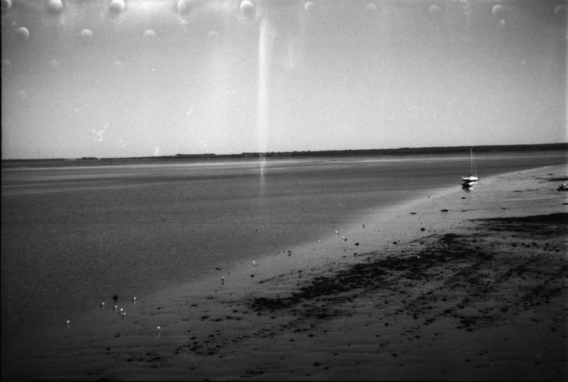

In a test roll they are evident almost to the center of the frame
Now the test: First I used black tape to cover the transparent window in the back door. No more circle marks but still a huge lightleak
Second step: some more tape over the lower eddge of the cover: no lightleaks. The causes of the problem were found.
Now I need to find a way to seal the lower edgge of the back door. A thin rubber seal is still there, I will leave in place and add some of the stuff Jon Goodman sent me.
Any other sugestions ?
