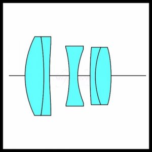

The iconic 4-element, 3-group Zeiss Tessar of 1902 is a vintage classic that has has been used by virtually every lens maker worldwide.

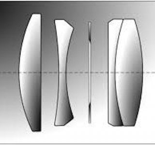

50mm f:2 Leitz Summar optical diagram.jpeg
The nearly symmetrical 6-element, 4-group "Double Gauss" design was widely used for fast lenses. This is Berek's 50mm f/2 Leitz Summar.

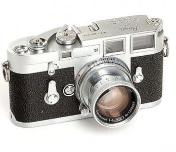

Leica M3 single stroke with collapsible 50mm f:2 Summicron.jpg.jpg
The Leica M3 of 1954, shown here with collapsible 50mm f/2 Summicron lens, ushered in the era of the modern multi-frame rangefinder 35.

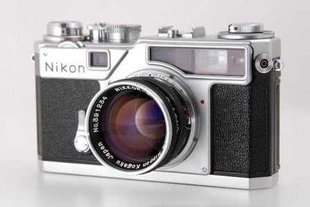

Nikon SP with 50mm f:1.4 Nikkor-S lens.jpeg
The Nikon SP of 1957 to 1960 was the apotheosis of the Nikon rangefinder 35. It's a collector's prize but also a great vintage shooter!

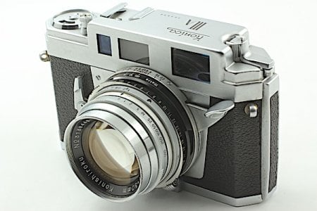

Konica IIIA with 50mm f:1.8 Hexanon lens.jpeg
Konica IIIA of 1958 has a magnificent 1:1 range/viewfinder with projected frame lines that correct for field frame size as well as parallax error.

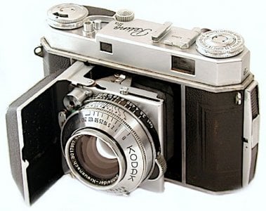

Kodak Retina IIa with 50mm f:2 Schneider Xenon.jpg
The Kodak Retina IIa of the early '50s offered a rangefinder focusing 50mm f/2 lens and a slimmer, handier form factor than later Retinas. Nice!

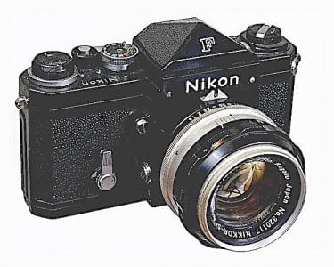

Nikon F: Shown here in black with plain pentaprism, 50mm f/1.4 Nikkor, it was the camera that ushered in the era of 35mm SLR dominance.

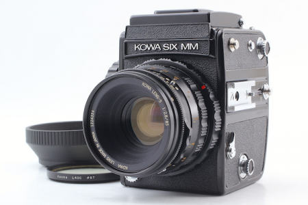

Kowa Six and Super 66
These are serviceable leaf shutter 6 x 6cm SLRs with a good lens line—Kowa always made good lenses. The less expensive Kowa Six has a hinged back and must be reloaded after each roll; the Super 66 uses odd L-shaped magazines that work well and commands higher prices. A full line of lenses and accessories was offered, but Kowas are most often found with waist-level finders. Overall quality of construction is decent and these cameras are reasonably reliable but hard to get fixed if they act up, Overall, a reasonably priced alternative for those getting into medium format SLRs.
Kowa Six MM. An upgraded Kowa Six with mirror lock and multi-exposure capability, it has a hinged back and must be reloaded after each roll.

1) Love my Nikon S2. With a Nikkor 50/1.4 it's amazing.

I love my Leica M3 dearly—it’s a late single stroke with 50mm f2 Dual-Range Summicron. However if I had to choose one 35mm camera to use for the rest of my life, it would be a Nikon F2 or a Canon F-1 NEW. Cheers!
