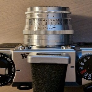

My name is Radek. I just bougt Bessa T. I'm using it with Jupiter 8 (adapter m39/M). Camera looks brand new.
I did one roll of Kodak on Saturday, however, I have a feeling that something is wrong. When I focused on an electricity pole at 200 metres, the distance scale on the lens showed about 15 metres. There is no mount M lens to check this on the original lens. If the pictures are out of focus, the rangefinder will need to be adjusted. I need your help. Is the hole in the picture for the adjustment spot? What tool do I need? How do I carry out the adjustment? I will be very grateful for your help. Thanks 🙂Zdjęcie WhatsApp 2024-11-18 o 21.36.18_ab3b783a.jpgZdjęcie WhatsApp 2024-11-18 o 21.36.18_0a8ab2bb.jpgZdjęcie WhatsApp 2024-11-18 o 21.36.18_3e835e50.jpg
It's most likely not the camera, but is either the LTM to M adapter being too thick, or the Jupiter-8 is way off. I've seen both.
The Jupiter is not made to the Leica standard, and usually needs to be adjusted. BUT- the error on your lens far exceeds the usual problems.
The adapter- I suspect is an inexpensive one? The thickness is critical for the distance scale to match the rangefinder. Yours seems too thin: setting the lens would push the camera past infinity. You might try another adapter, or cut out a piece of paper (or two) and place between the lens and adapter as you screw it on.
Hi,
thank you for your quick reply. I have used this Jupiter 8 on the Bessa-L before and there was no problem, even though I set the distance by feel. Perhaps the fault is actually on the side of the adapter. Mine cost about 25 USD and I believe it is manufactured in China. I will try to buy a used Leica or Voigtlander and see what the effect will be. I like this Jupiter 8 and would like to use it. Thanks for your help. Please find attached pictures of the Jupiter 8 on the Bessa-L
