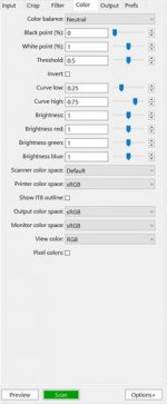

If somebody could give me a screen grab of the 'color' tab options on their Vuescan that would be fantastic, the website only tells me that 'advanced features' are available with the Pro version, Id like an idea of what those advanced features are. Ive attached the features I have under colour, im pretty sure this is a trial of the basic.

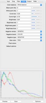

Here is screen capture from version 9.5.55. x.x.57 is available, updated Oct 13/16, but the link on the website still takes me to x.x.55 so I haven't updated. I can't imagine it would be all that different though.

Also keep in mind that some features are scanner specific, and will only show up when the correct scanner is connected.
