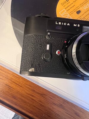

I’ve got two little chips in this vulcanite. Anyone ever patch it with milliput putty? Any tips on the best way to duplicate the original texture? I considered just reskinning the camera but this is so minor if I can make an almost unnoticeable repair I’d rather keep the vulcanite.

In my most humble opinion recovering a camera devalues it.
I have used Milliput with some success, in other words it is quite hard to find the patch. I used a toothpick, a glass of wine and some patience to 'texture' it.

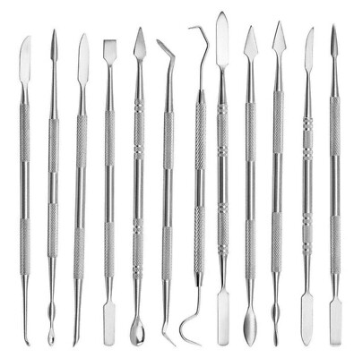

I was fortunate in that I had retained all but a tiny piece of the detached vulcanite so most of it could just be glued back in place using a suitable glue and in the small missing area I was then able to pretty much match the vulcanite's pattern enough to make it convincing. From memory I used the sort of modelling tools depicted in the first eBay link below as part of the project + tweezers for handling small bits of vulcanite.

PS I am not familiar with Milliput (specifically) and have not seen it here in Australia. I imagine from its name that its a kind of epoxy putty which can be worked with the fingers to mix the active ingredients and is not "goopy" and ultra sticky as with many epoxies including some that have a paste like consistency. We do have some such epoxy putties like this, sold by other names, and I have used them for other purposes. In this case I would be inclined to roll out a thin sheet and press this into the gap. Use a flat board to level the top to the same level as the vulcanite. Then use the kind of tiny hobby tools I linked below to replicate a reasonable facsimile of the vulcanite's texture. Problem is of course is that in my experience, this stuff tends to set quickly so working time is strictly limited........................so I suggest it only as a potential option but one which would have issues.

I've repaired a few small areas in two M2s and my results were not perfect by any means. If I knew then what I know now, I'd say start with just a little putty, adding extra as needed. Even it out so that it is flush with the vulcanite and then 'texturize' it with a toothpick (or some such) as best as you can. It is not going to be perfectly similar to the adjacent vulcanite but it will not be easy to spot either. The advantage of the repair is that you get to keep the original (very grippy) covering and the vulcanite will not chip any further than it already has.
In the past I have used a ball of epoxy putty to make a “stamp” by lightly lubricating (to ease detachment) a good flat area of vulcanite on the affected camera and pressing the ball against it. When hard I have used this to impress the pattern on the repair putty. I have tended to do this off camera then cut to fit the gap but I suppose it can be done in situ.
