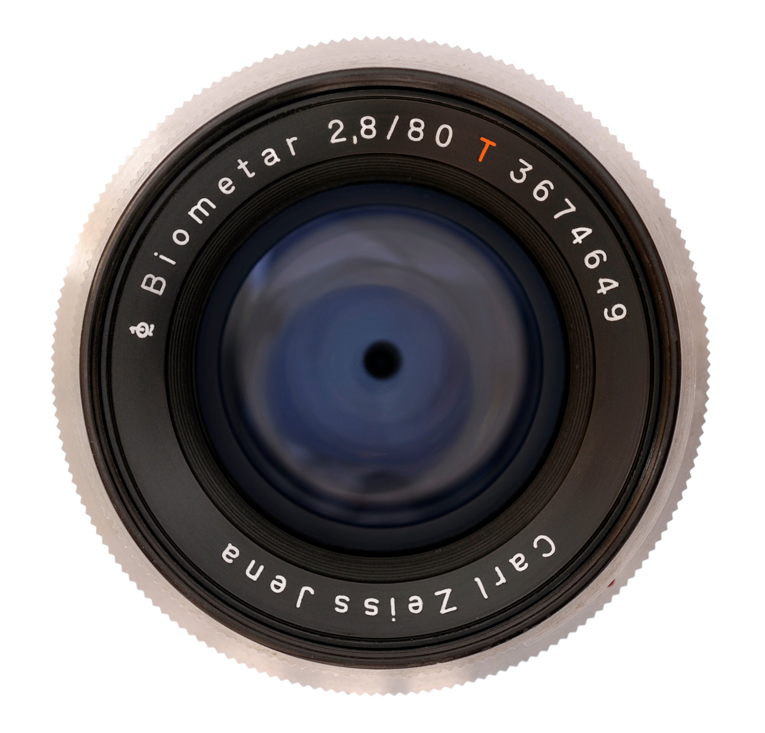

In case you have not seen it, this is also a very informative article about the development and evolution of the Biometar.
Biometar | zeissikonveb.de
Carl Zeiss Jena Biometar. Biometar 80 mm f/2.8. Zeiss Zenzanon. OPREMA.
