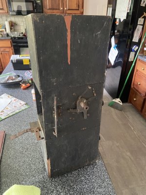

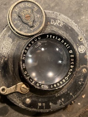

Hey folks, new here. Today I was out and about looking for a 35mm camera for my sister, and ended up finding a 35mm at my first stop.
The drawback? This is a nearly 2ft long contraption of a camera. Someone made this, but why? Anyone ever seen anything like it? This camera has 3 sections to it. The top holds a large reel of film, the center is the camera mechanism, and the bottom is where the used film is stored. On the outside there is a mechanism to advance the film, a lever on the front that activates a film cutter, and a disconnected lever which somehow worked the shutter probably through some sort of linkage.
The lens does have some haze. I’m guessing it’s an old coating that’s no good. Or barn dirt.IMG_2367.jpegIMG_2368.jpegIMG_2369.jpegIMG_2370.jpegIMG_2371.jpeg

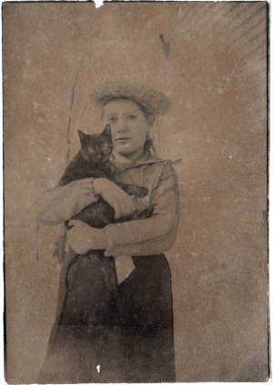

What Shawn is talking about is the Mandel and Mandel-ette cameras made by the Chicago Ferrotype Company. These were essentially a tintype on paper process, an example of which from my personal collection I will attach below.
Your camera is not one of these. I suspect your camera was made for such a purpose as making photo IDs, or perhaps even a security camera (if it has an everset shutter it could be rigged to take a photo anytime somebody opened a door, or set up with a timer to take a photo once every minute) at the end of the day the film would be cut and developed. What's the shutter and lens?

Dating this contraption will be hit-and-miss. My guess is 1930s. What size film did it take? The assembly for it to slide across the lens looks to be for a bulk roll of some sort. Is there still a take-up spool? If yes, this will give you an idea of what film it used.
From your images, the lens and shutter assembly looks to be European, maybe 1920s. As for the rest, it looks like it was crafted in somebody's workshop from leftover bits and pieces. Not that this means it worked less well, of course.

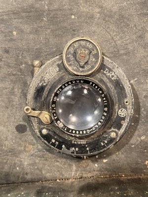

The lens/ camera bits are German labeled ISBOR DRP. The examples of this (complete) camera online have it listed as a plate camera.

This unit has no take-up reel at all. What I’m guessing is you took your photo, cranked the side mechanism once or twice, then pulled the lever on the front to cut it. I could be wrong of course. There’s no take up reel, just an empty box in the bottom which collected the used film.
Another side note here is the lens has some haze with some scratches in this haze. It seems to be either barn dirt built up or a lens costing. I’ve tried to carefully clean it with no luck.
As for what to do with it, I have no idea. As a kid I collected cameras but sold most of them years ago. Long story short, as a kid I was an awful photographer. I had a Pentax and Olympus camera and it got to the point that my folks wouldn’t get my film developed anymore. This was in the waning years of drug store development and no parent wants to spend money on all the film and failures a guess. In the end I saved my grandfathers Argus C3 and got it all cleaned up. I was planning on using it when this camera came along.
What I’m going to try and do is find a man here who does wet plate photography for cordell hull birthplace state park once a year. No one has been able to give me his contact info as of yet. I’d like to see if he either wants to borrow this unit or buy it. I work for parks and know the patrons would absolutely love to have this thing set up for demo.
What I’ve also considered is giving this thing a try in a few months when my seasonal job ends. I just worry about exposing the film with how this thing is set up. I don’t mind having it developed and sent back as just negatives since I have a high end scanner.
Just some thoughts. For $10.00 I just had to get it out of that barn and play with it. And the hunt for a generic 35mm for my sister continues. Thank you all for your input and info on this. Best bet is a carnival camera.

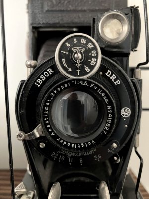

I can't quite read the text around the lens, but the lens/shutter mechanism may have been cribbed from something like the Voigtlander 116 Rollfilm camera. The camera in the photo was my mom's, from the 1930s, and also has haze between the elements. The shutter is accurate still, though, even after sitting for the better part of 7 decades since it was last used.
That’s in much better condition than mine. Here’s a couple photos of the lens on mine. Certainly German.

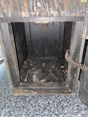

It cleaned up better. It’s difficult to clean the rear because of the film contraption in the back, but it should take a visible picture .
I’m wondering how on earth I can even load this with film. It looks like it took some large spool which reminds me of what a friend of mine told me. He said that speciality rolls of film you see online are often old movie 35mm. Maybe that’s how this was done. Of course I know nothing about how film was done back then besides the little loaded rolls of film.

The lens is a Cassar made by Steinheil from Munchen (Munich), the shutter I'm not sure. Steinheil were a significant manufacturer of various optical equipment.
