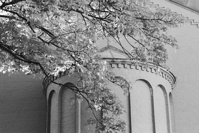

Hello Peter
I have only tried the 80S so far and I used Rollei Supergrain, I shot the film in my IIIg. @80iso
I developed per the Mass Dev chart and found it very nice but the highlights were a little blown so I will adjust the agitation
I have a roll of the 400 in the Hasselblad and I haven't decided which developer I am going to use yet.
Attached are a couple from the 80S roll.
Thanks
Don

In all these photos, the highlights fairly blaze. Toning them down is the goal.
