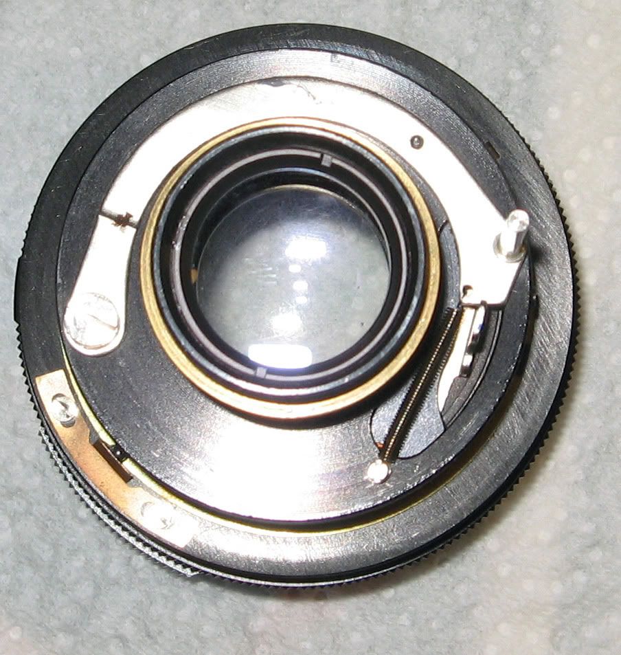

DAG did mine, it had heavy fungus. fast turnaround and affordable. no regrets. came out exactly like new.
i bought the FL version, it was about like yours, and did it myself. it came out OK but i had a speck of dust on an inner element when i was done. pretty simple lens.
heres a before pic.
